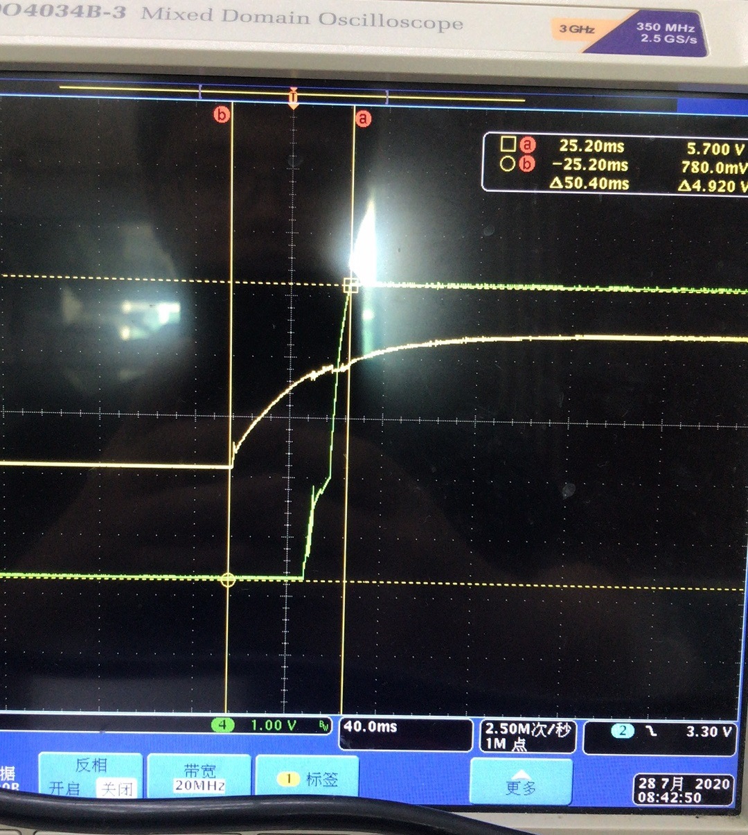

customer schematic as below. C41,C45,C44 is NC, input is 5V, output IS 5V/2A.
Here is the test summary

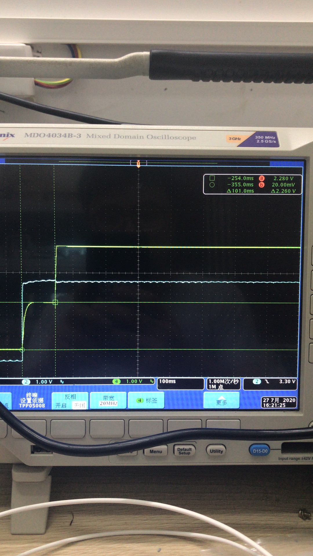

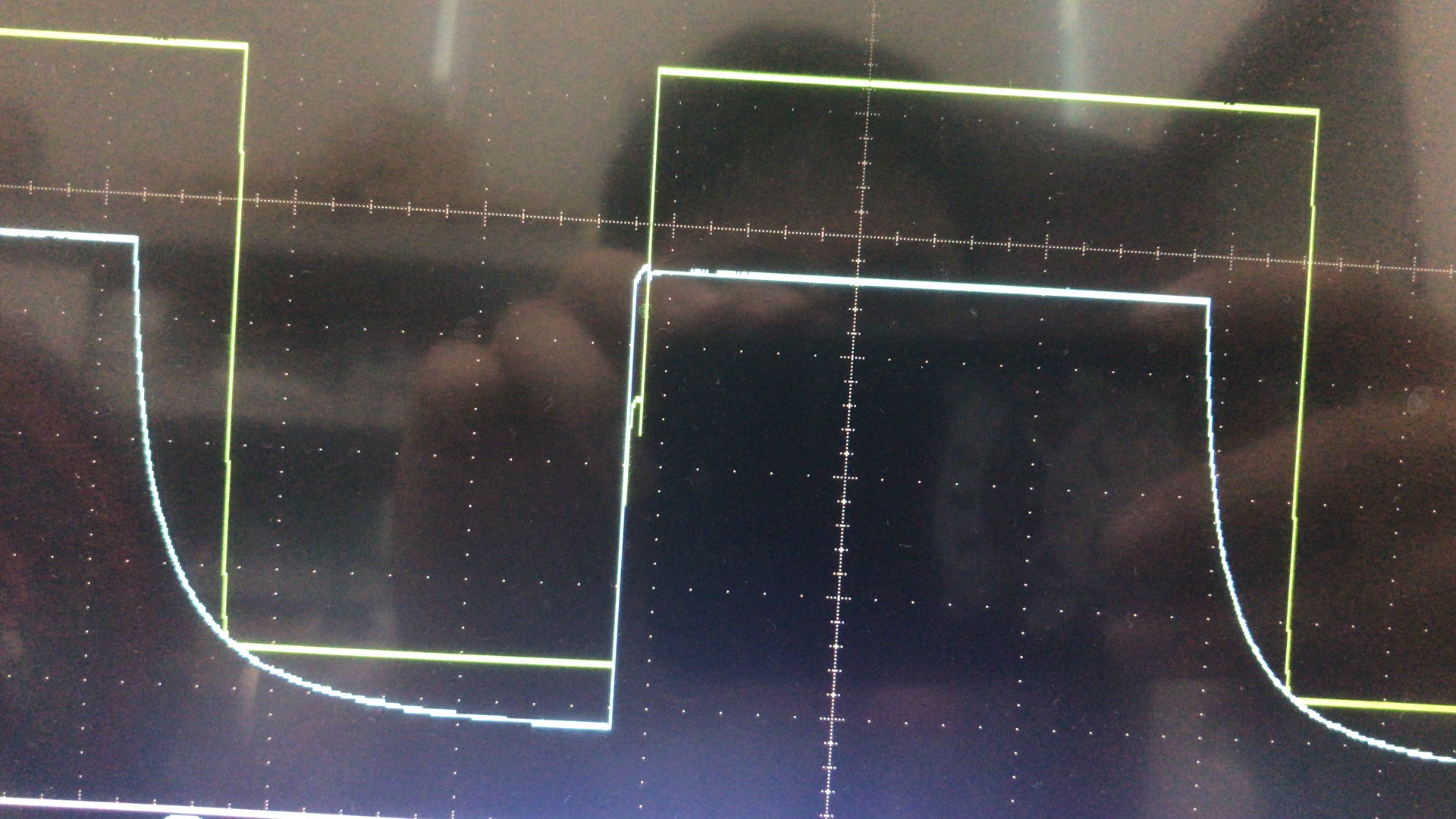

1. remove C42, connect PS and VINA, use NPN to control EN, found the output have a step, the voltage of step is about 2.28V
2. PlaceC42, connect PS and VINA, use NPN to control EN, found the output will ring at 2.2V
3. place C42, connect PS,EN and VINA,the output is normal, not step.
waveforms:
1. Blue is EN , Yellow is output
Why the ouput have a step when use NPN control EN pin? how to reduce this?thank you
