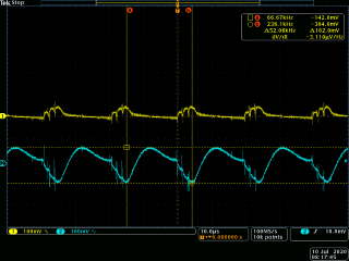

I found that the part is causing substantial Vin noise on my implementation at most input voltages. I performed the same set of tests with the TPS61020EVM-025 and found mostly the same results, my implementation is actually a little better, at a Vin of 3.05V, the noise is gone.
This is not really an acceptable condition, any suggestions on how to remove the Vin noise?
Test conditions:
 * Vin as shown with scope pictures.
* Vout is always 3.3V +-1%
* Load is 73.5 ohms, drawing a constant 45mA which simulates actual use load.
* The Vin source is a bench supply. I did try 3 different bench supplies as well as 2 Alkaline batteries. All of these sources showed the same results.
Except for the first picture, all others are using the EVM so the schematic and layout are TI's...
Yellow trace is Vout, Blue is Vin, both are channels are set to 100mV per div ,AC coupled.
My design @ Vin = 3.05

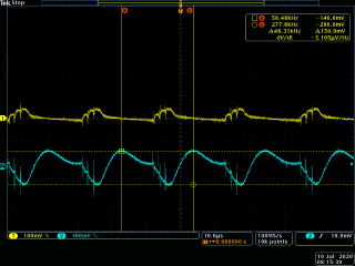

EVM @ Vin = 3.05

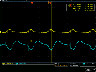

EVM @ Vin = 3.22

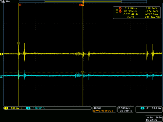

EVM @ Vin = 2.88

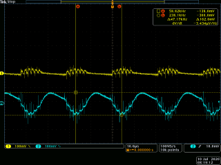

EVM @ Vin = 2.00

  • Hi Steve:
    I think it's caused by PFM mode. Power save mode is used to improve efficiency at light load. In power save mode the converter only operates when the
    output voltage trips below a set threshold voltage. But it will bring the lower frequency ripple.
    May I know if it's harmful to your system? And have you tried set PS pin to HIGH to disable the power save mode?
