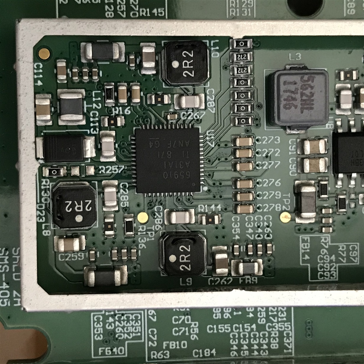

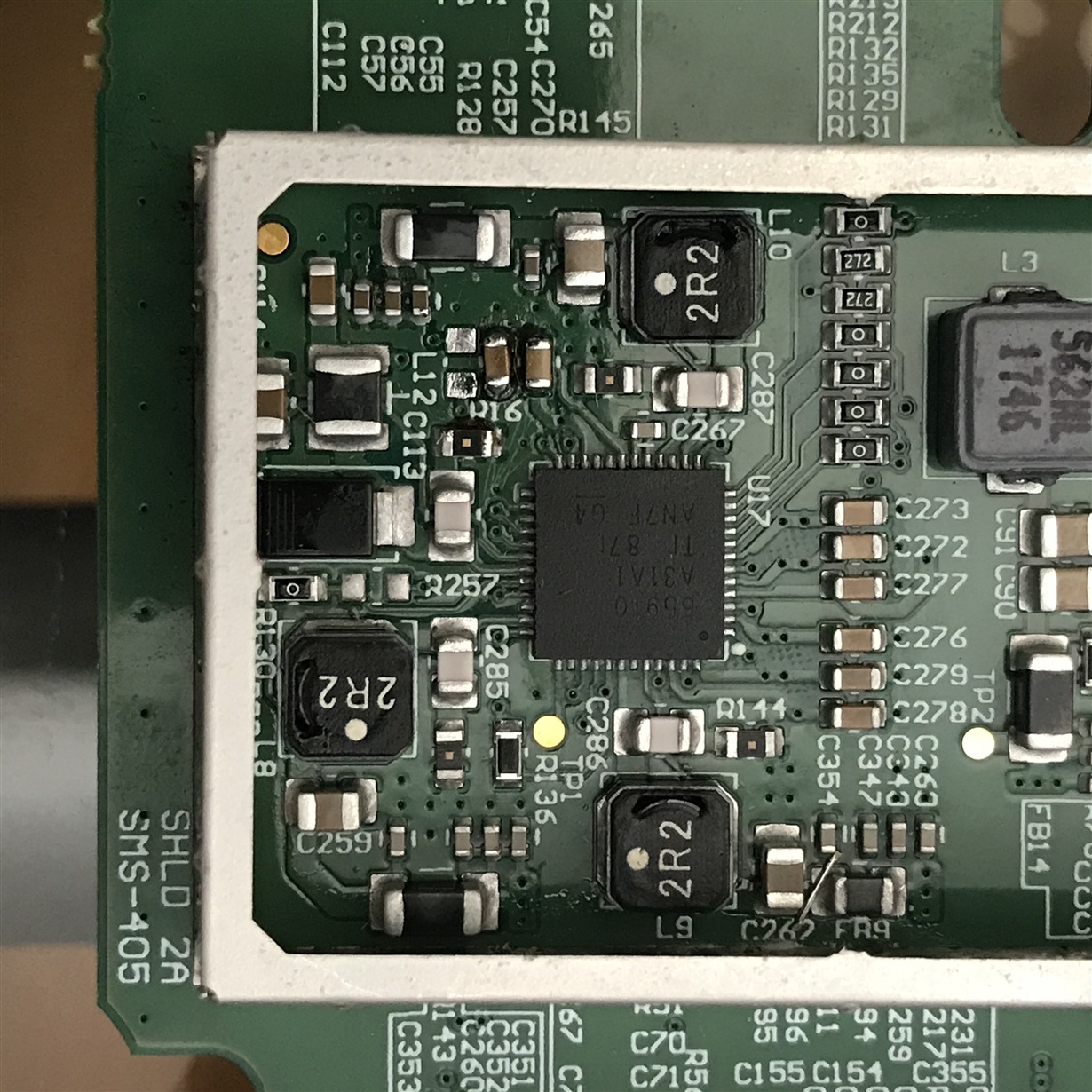

  • Please provide a photograph showing the top-side marking for one or more of these TPS65910A31A1 devices.
  • Hi Brian,
    Please see attached.  The second image #4943 is one with the issue we are seeing.
    Thank you,
    Mark Latham

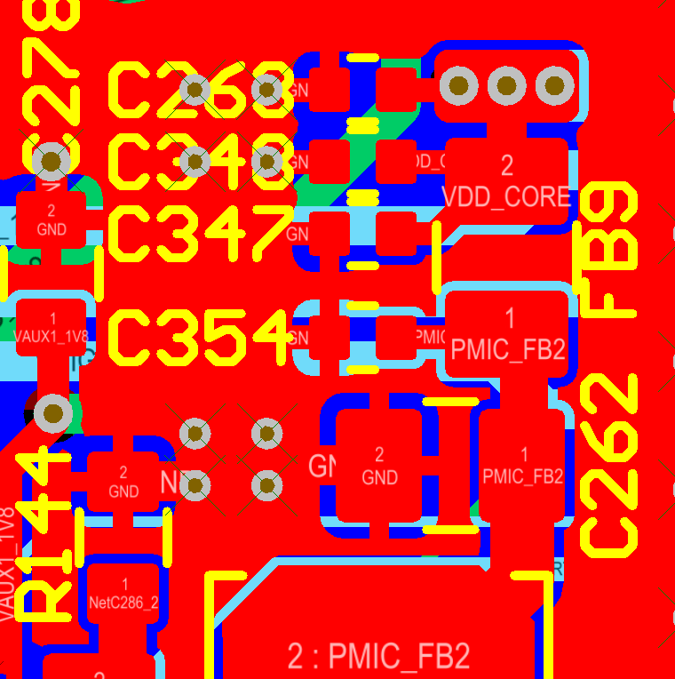

  • Hi, Mark,
      There are 2 issues with the second image #4943:
    1. R16 (I guess) is missed.
    2. C354 and C262 may be shorted.
       I'll let Brain to give his comments.
  • Hi Phil,
    Stray wire - the contact points are all the same node (see below), so no harm and unrelated to VRTC startup.
    R128  - removed because it caused at 180uA drain on VRTC (assuming the 65910 GPIO was at 0V).
    Of course this is just one board, from one production run, and we've had many with VRTC issues.
    Thanks for your response, very astute!
