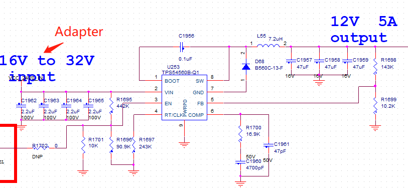

Hi, I want to know whether the application of the output circuit of 12V 5A is correct or not.
I am looking forward to hearing from you, thank you very much.

The design looks reasonable.
Although i would suggest to copy the webench compensation value as shown on this link (R1700, C1960 and C1961) and increase the inductance to 15uH
