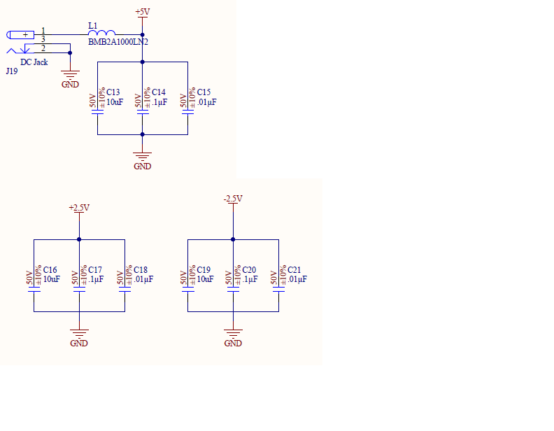

Hello TI Support Team
We are using LM27762DSST(U7) to provide +2.5V & -2.5 Supply to a Analog Mux ADG708CRUZ (U1 to U6)which is the Load,  6 Mux are used in the Circuit.
Observations : Using 5V Lab Bench PS when we power on the U7 & Mux is not enabled, we see the following
1)+2.5V GOES TO 2.3V instead of 2.44V- Please refer to Circuit Diagram below
2)-2.5V goes to 1.33V.
3)Upon reducing External 5V to4V or below we see the outputs are +2.4V & -2.4V.
4)It remains stable till Extenal 5V drops till 2.5V.
5)Directly Power on with External Supply at 3.3V the outputs are +2.33 & -1.33V.
Portions of the Circuit are shown below U7 & U1- 1 Mux Connection & Capacitors used are X5R/X7R Type.
Can you please let us know what is wrong with Our Circuit or U7?? -2 PCBS have been tested & behave the same way.
