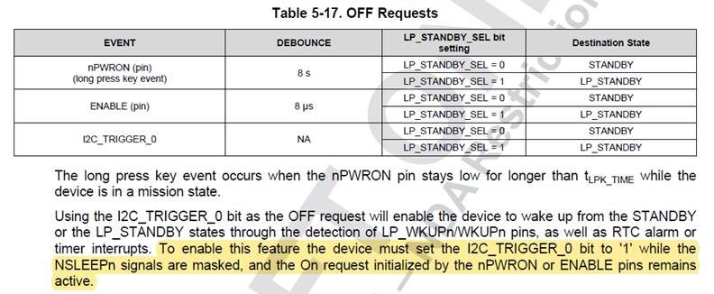

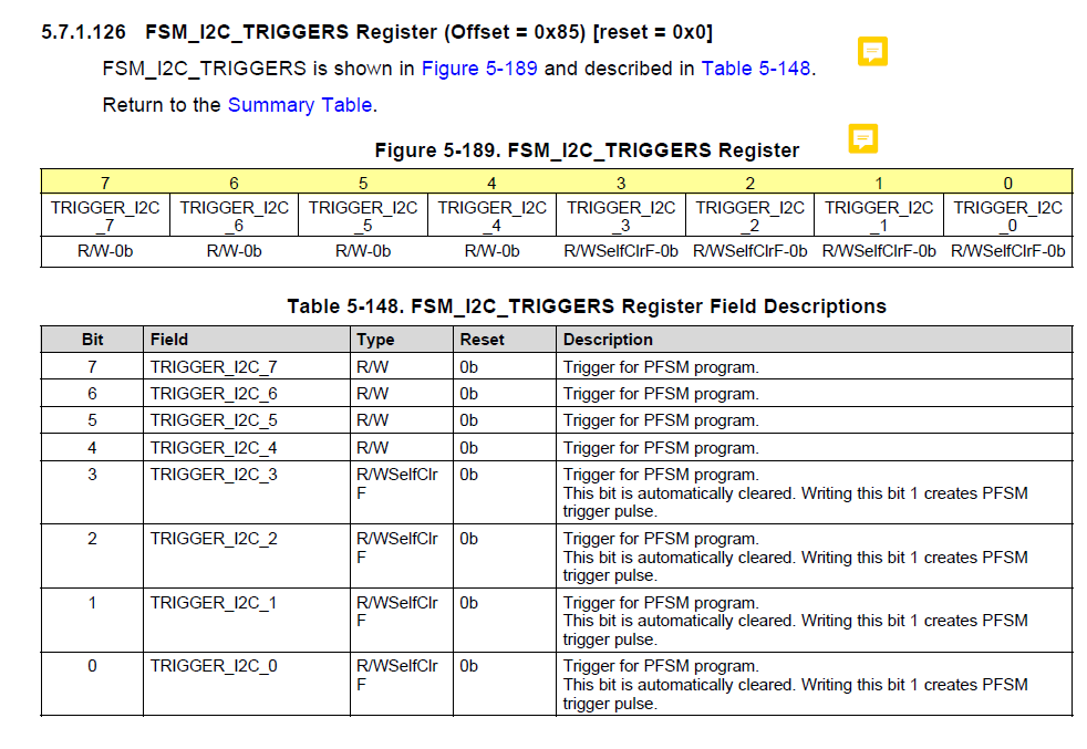

I want to send the OFF Request with I2C to the PMIC (From TDA4VM A72 Core) and I found the following infromation in the datasheet:
With this I concluded the i2c command that I Need to send can be the following, Could you please tell me If I am correct here or I need to consider something else?
#Unlock the register
/usr/sbin/i2cset -f -y 2 0x48 0xA1 0x9B
#Send the Off request
/usr/sbin/i2cset -f -y 2 0x48 0x85 0x01
Pouyan
  • Pouyan,
    Hi, you are correct. You just need to write I2C slave address 0x48, register 0x85, data 0x1.

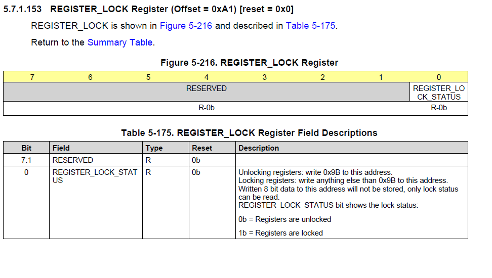

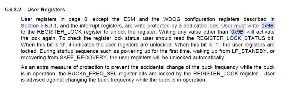

  • Hi Nastasha,
    thanks for the clarification. For the 0xA1 in the page 120 it is written that all the registers are default locked and to change them the value 0x9B should be written at the REGISTER_LOCK which is at 0xA1. So thats why I added this. When this is not needed then I wont use it.

  • Pouyan,
    I confirmed with our design team that the registers are unlocked by default. We will update our documentation to reflect the correct behavior. This means you shouldn't have to write to the REGISTER_LOCK_STATUS.

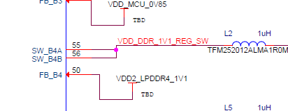

  • Hi Nastasha,
    Thanks for the hints,
    I messured the TP163 on the EVM which is connected to BUCK4 and DDR, it was 1.14V
    which mean that the memory is still powered and the device goes to S2R, the question now is how can I put the device to Standby mode? Clearing the Interrupts moved the device in S2R.

  • Pouyan,
    I dug into this a little deeper, and I think I might have missed a step in the process. After you clear the interrupts, can you mask the NSLEEP1 and NSLEEP2 bits? I think that since they are unmasked, the device transitions to S2R instead, since they are higher priority triggers. Try masking these, then setting the I2C bit.
    Nastasha
  • Hi Nastasha,
    Yes this worked perfectly.
    I masked the NSLEEP1/2, then clear the Interrupts and at the end send the off request.
