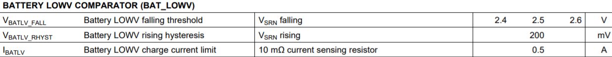

    Yes, the BQ24725A can revive a deeply discharged battery. If VBAT < BAT_LOWV, then the BQ24725A can still charge the battery, but the charge current is limited to 0.5 A (assuming a default 10 mΩ sense resistor).
    For example, if your ChargeCurrent() register setting = 1 A, then the actual charge current will be clamped to 0.5 A. After VBAT rises above BAT_LOWV, then the BQ24725A will charge the battery with the full 1 A ChargeCurrent() setting.

    Even if VBAT is far below BAT_LOWV, my previous answer still applies. The BQ24725A can still charge the battery, but the charge current is limited to 0.5 A.
    After VBAT rises above BAT_LOWV, the BQ24725A will start charging the battery with the full ChargeCurrent() setting.
