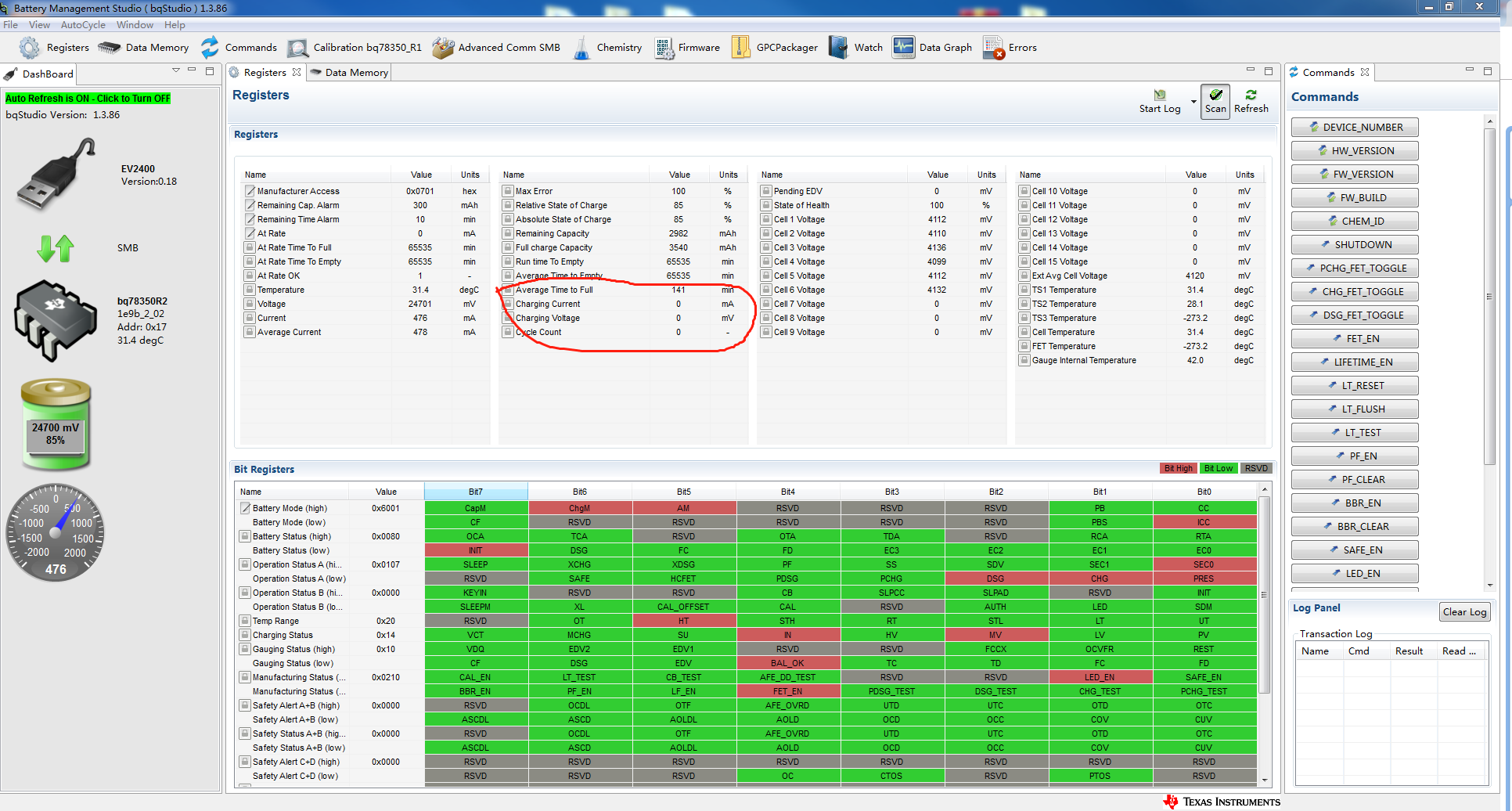

BQ78350-R2-DEVICE-FW: 充放电正常,但是为什么充电电流和充电电压都为0呢?看图充放电mos都打开了,而且还检测到我的充电电流,为什么是0呢?
Part Number: BQ78350-R2-DEVICE-FW
    For other users, I am posting the English translation of your question: "Charging and discharging are normal, but why the charging current and charging voltage are 0? Looking at the picture, the charge and discharge mos are turned on, and my charging current is also detected. Why is it 0?"
    From your register window, it looks like the [IN] bit (Charge Inhibit) is high which indicates that the device temperature is outside of the allowed range for charging. You should check the temperature settings. Specifically, check these data flash parameters to see why this might be happening:
    Charge Inhibit/Charge Suspend Low Temp
    Charge Inhibit High Temp
    Temperature Enable
    Temperature Mode
    It is also good to run calibration on the temperature measurements to make sure they are accurate.
