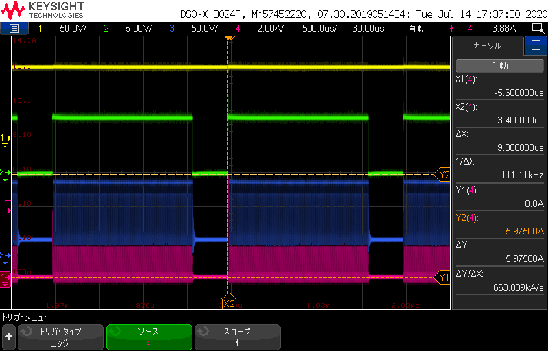

TPS92691 occur unstable operation by overcurrent on every PWM dimming start.
I guess that switching current increase more than overcurrent during PWM logic low state.
And continue to reach overcurrent on every PWM dimming:high.

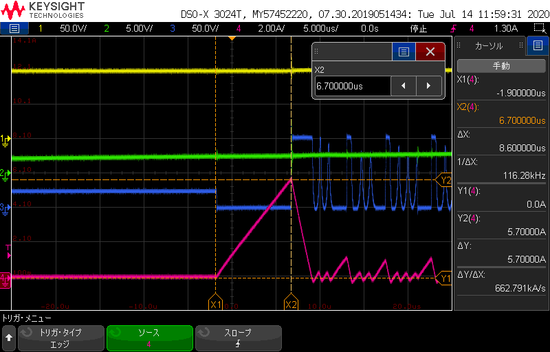

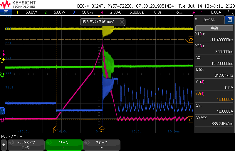

Waveform for limit of stable (Iout is about 50mA), and unstable (more than 50mA) are attached below;
※Yellow: Vout, Green: PWM, Blue: Vsw, Purple: Isw
・Stable, but occur large switching current
・Unstable, inductor current rating was saturated
