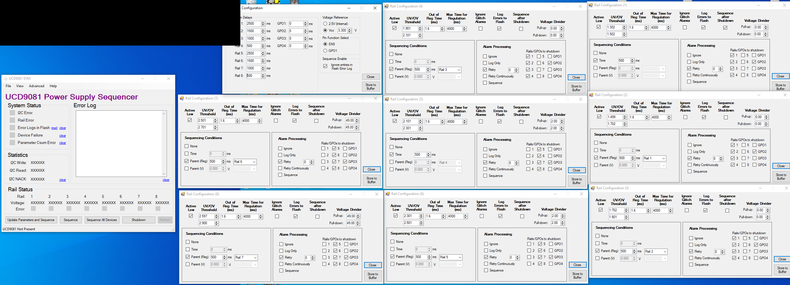

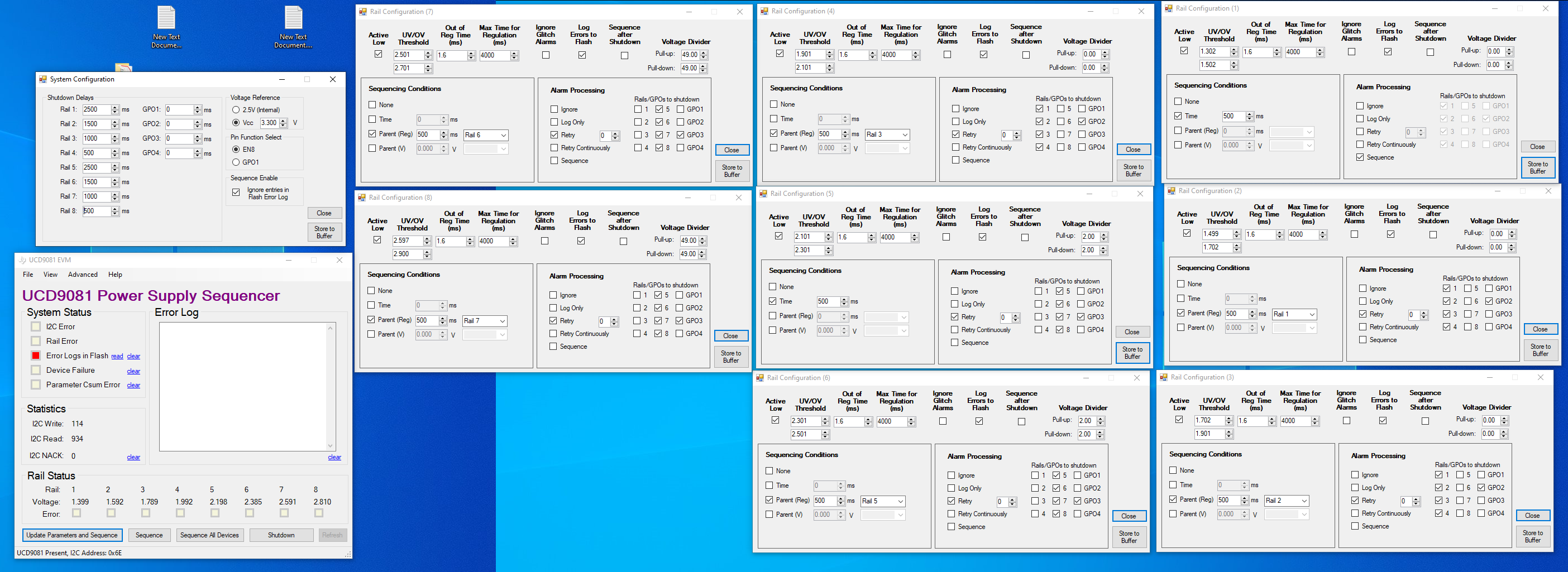

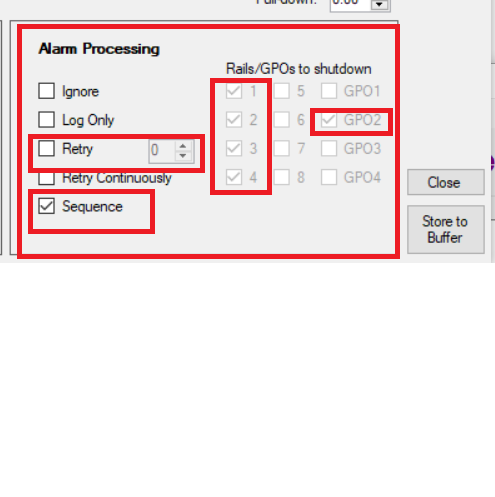

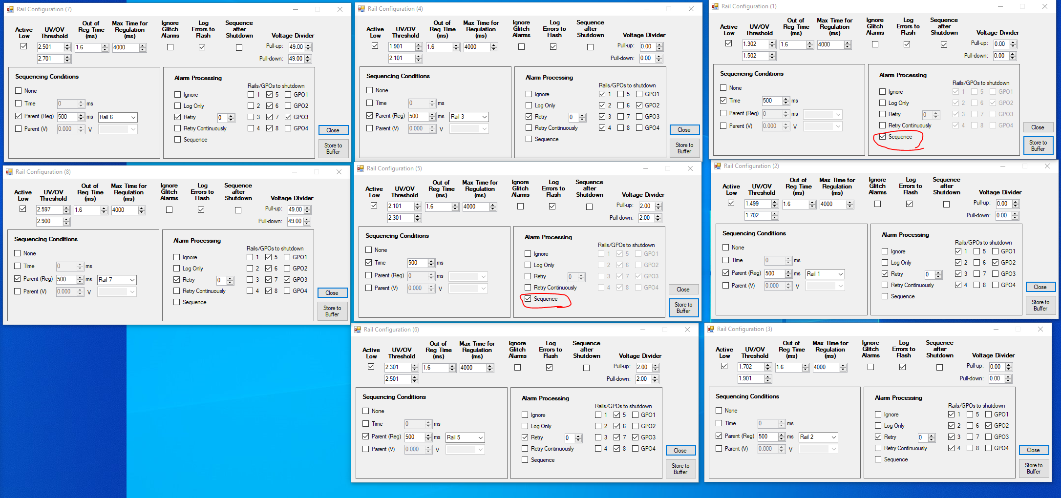

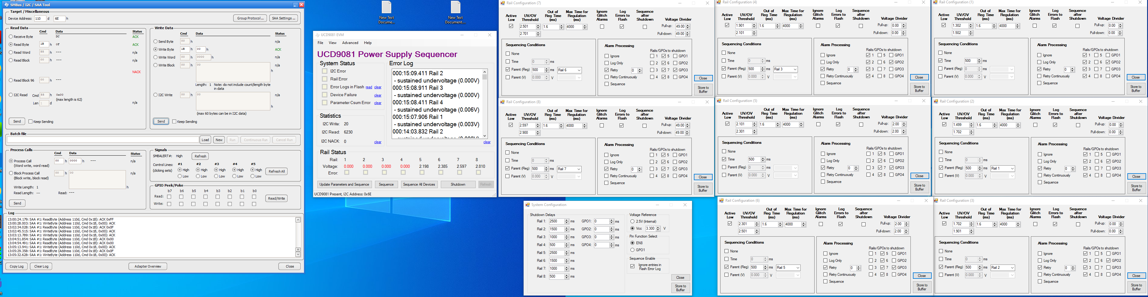

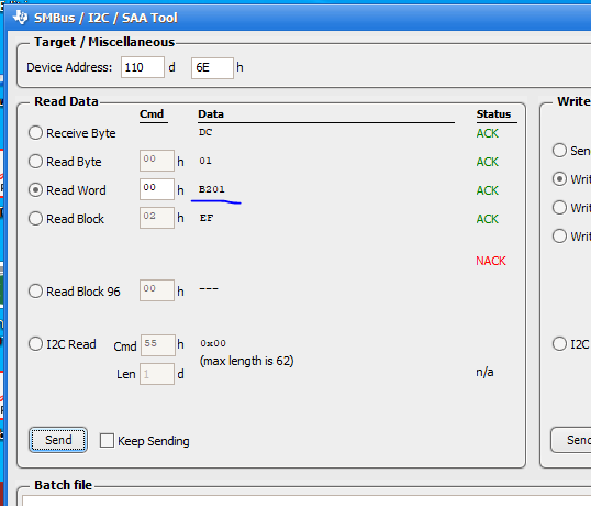

I do some tests on the UCD9081 EVB. Further to what we talked about use UCD9081 for two separate device.
I was succeed to shutdown device_1 (EN1, EN2, EN3, EN4) with fault with FET on MON1 "0", and keep alive device_2 (EN5,EN6,EN7,EN8).
but when I release FET on MON1 "1", the device doesn't wake up.
and if I checked "sequencer after shutdown" all the device 1 and 2 constantly trying to perform sequence.
how could I do power down and power up for 1 device with the FET on the MON?
