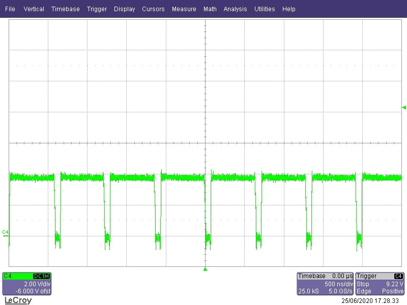

Hi.
We got a question about LM53600-Q1.
We are using PN LM53600NQDSX, with fixed output at 3.3V.
Input voltage is between 11V to 13.5V, but it should operate good at 4V and 16V too.
Current consumption will be lower than 50mA.
We have simulate it with webench before to realize design and we have follow suggested schematic and layout.
We have connected SYNC/MODE to GND according to datasheet note in order to reduce EMI in case of light load.
Now we are debugging it and we are noticing that on switch pins there is undesired oscillation.
This appear over 5V. At 4V we are seeing correct waveform as reported on webench.
Moreover, we have seen that VOUT is a bit more than expected 3.33V.
If we connect SYNC/MODE to high level, VOUT is 3.3V and oscillation desapears.
Do you have any suggestion or explanation?
Thanks in advance
