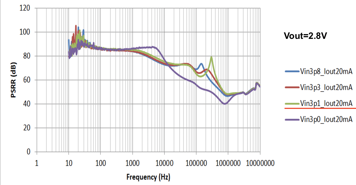

  • HI Shmuel,
    300mV of drop-out should help a lot with filtering. Here is a plot showed PSRR with a 20mA load and 300mV drop-out:
    The SOT-23 package of this device will release by the end of September which would also meet your minimum pitch requirements.
    Does this work for you?

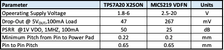

  • HI Shmuel,
    Here is a quick comparison between these two devices. From your application and drop-out, the MIC5219 will not be providing much filtering:
    Let me know what you think.

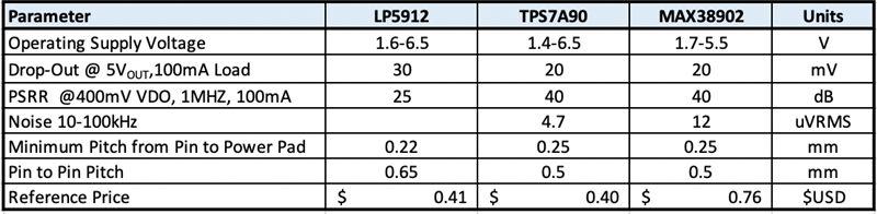

  • HI Shmuel,
    Have you looked at our LP5912?
  • Dear John,
    Thanks for getting back to me.
    I had a look at the LP5912 and yes the package looks good. But as you outlined in your table and I double checked in the data sheets it appears that the MAX38902 has a better PSRR ?
    Best regards
    Shmuel
  • Hi Shmuel,
    For equivalent PSRR and better noise, how about the TPS7A90?
    What do you think?

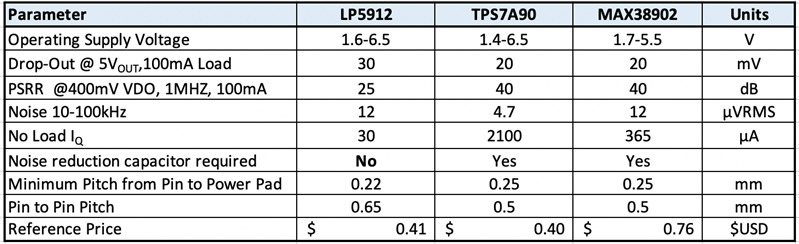

    Why do you think that the LP5912 is so much greater than the MAX38902A ?
    Best regards
    Shmuel
  • HI Shmuel,
    The MAX38902 requires an external bypass capacitor to get low noise performance. While it does not seem to be a care about in your application, the MAX38902's IQ is >10x that of the LP5912. See more detailed comparison below:
    If you are looking to minimize PCB area, the LP5912 does the job with one less external component.
    I hope this helps to clarify.

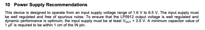

    Also I am going to use the MAX77827 and set its output to 5.3V. In the data sheets for the LP5912 it states "the input supply must be at least VOUT + 0.5 V" which I can't fit this requirement !?
    Best regards
    Shmuel
  • Hi Shmuel,
    With respect to the output noise, I can only do the datasheet comparison. Based on this, the noise performance seems to be equivalent.
    As for the 0.5V recommendation, this is written with the assumption you have a 500mA load and is a suggestion to have a lower noise well-regulated output:
    I do not think this applies when you plan on having a maximum load of 100mA. Note: the Typical application curves in the LP5912 datasheet are with a delta of 0.5V, the MAX38902 uses a delta of 1.1V.
