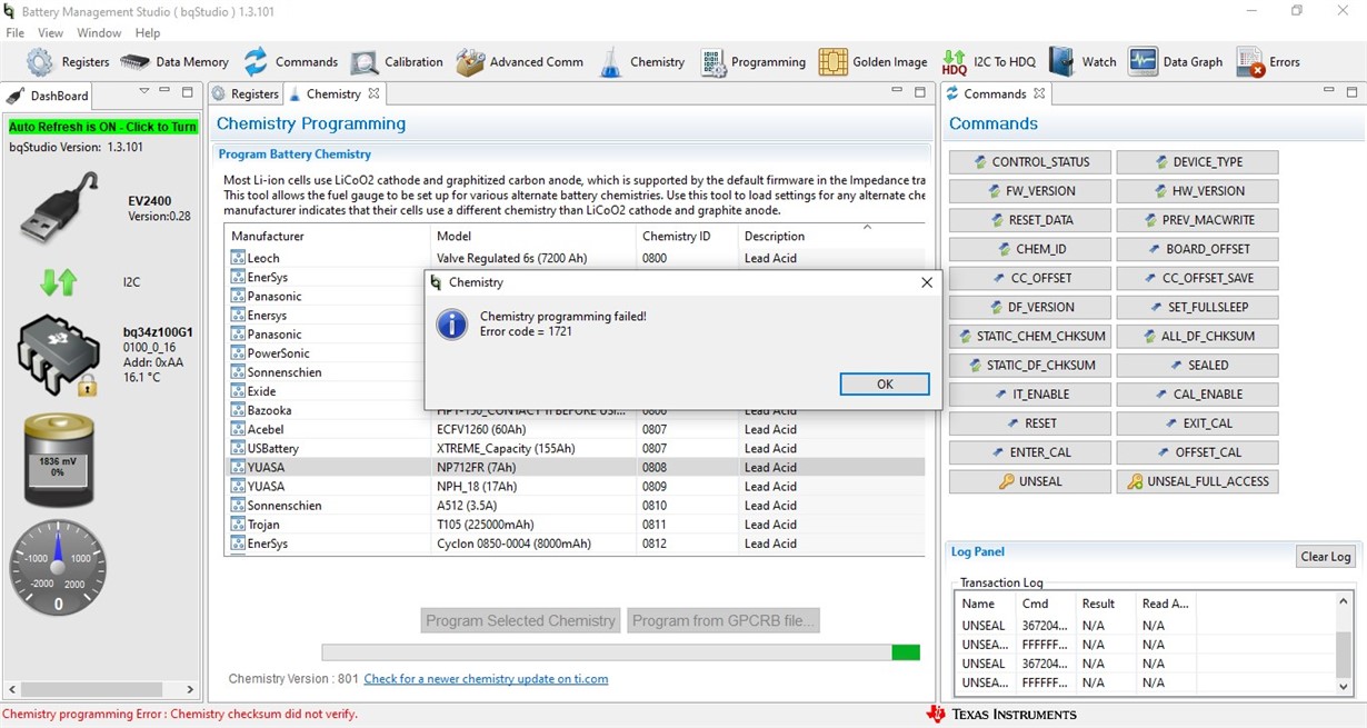

how can I calibrate the battery voltage to 12 volts and change the settings for pba.
thanks for the attention
Hello Julian,
You will need to find the best ChemID for your battery then configure the gauge for your batteries specs.
This should help with the configuration: e2e.ti.com/.../6747.SLUA925_5F00_bq34z100_2D00_G1.pdf
Is bqStudio giving an error when you try to calibrate?

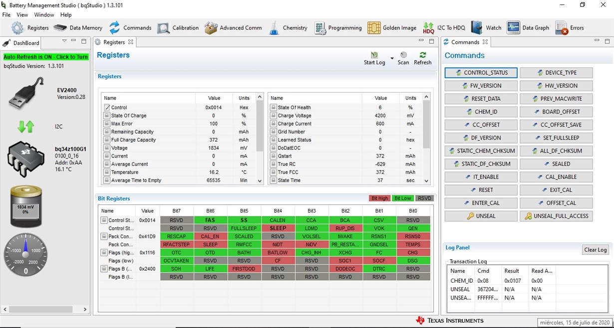

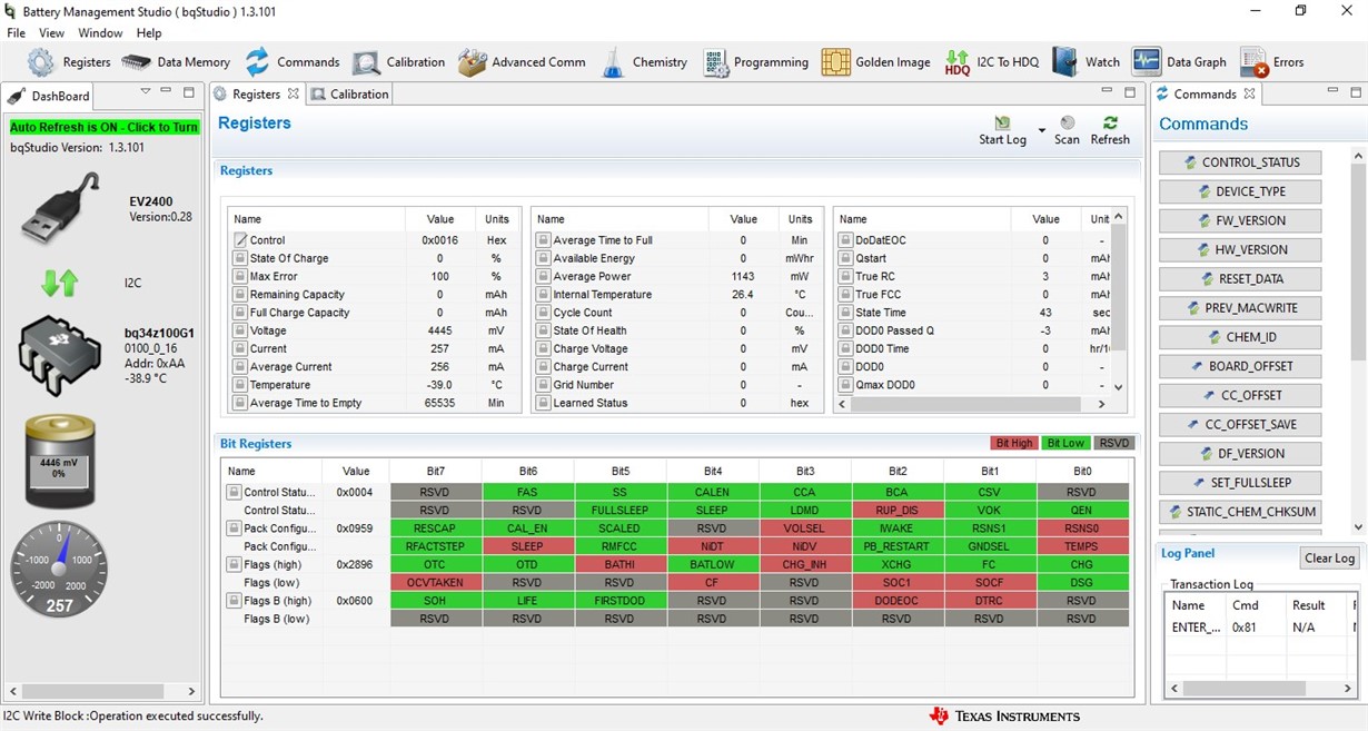

Hello Julian,
Did bqStudio auto-detect your EVM when you connected it? If it didn't auto-detect I would recommend updating the firmware by downloading the firmware updater from the product page.
Once you have updated the firmware, try turning off the auto refresh (top left corner) by clicking it then try to program the chemistry ID.

hi could you tell me the steps for the firmware update i am directly developing the board for the bq34z100 g1 or should i download any golden image to start the development.
Thank you for your attention
Hello Julian,
Do you mean you are using a custom PCB? You should be able to generate the golden image then use that to program other gauges with your calibration factors and other information.
This thread may be helpful for you as well: https://e2e.ti.com/support/power-management/f/196/p/911750/3386932?tisearch=e2e-sitesearch&keymatch=checksum%20did%20not%20verify%20bq34z100#3386932
