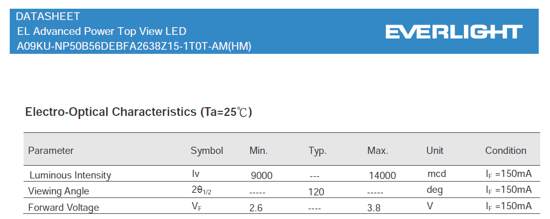

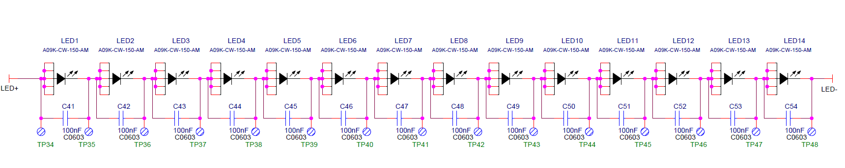

At present, our logo light scheme adopts tps92692-q1, driving 14 LEDs (current 150mA, voltage 3.2V), external PWM input to adjust brightness.
TA = 25°C, VIN = 12V, VIADJ = 1.59 V, Cvcc = 2.2μF, Ccomp = 10pF, Rcs = 300 mΩ, Rt = 20 kΩ,Vpwm = 5 V ,60HZ,
The problems encountered are:
After inputting VPWM = 5 V, 14 LEDs will flash after 60Hz. After adjusting PWM pulse width, what changes is led flicker frequency!!! What we need is that the LED is always on, adjust the brightness through PWM!!!
