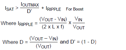

My customer now use TPS61194-Q1 in their applicaiton.
Their Vin=12V. Vout=24V, current setup is 100mA*4.
May I ask whether I could use the following equation to calculate the input current?
Vin*η*Iin=Vout*Iout
12V*85%*Iin=24V*400mA
Iin=1A
So the input current need at less 1A, right?
Thanks!
