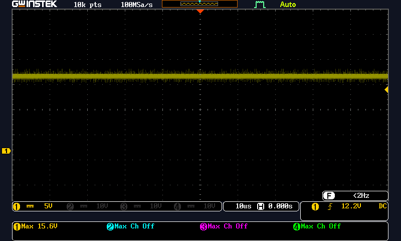

    Colin: Check the frequency and amplitude of the GATE pulses at the MOSFET gate. Double check the ground connection from MOSFET source to GND of the controller.
    Mert: Done. But I could not see the gate pulses, I see just high (Vcc of the driver) just increase Vsense to above 1.5V. Please find UCC28180 gate output scope below. As you can see frequency is OK but amplitude is not OK. Since it could not be 0V, gate drivers output is just only high.
    Since the last results are not correct, I stopped tests at this stage. Do you have any idea to what could cause to this problem?

  • Hi Mert
    My mistake, COMP is held low by the FAULT switch (see the block diagram). The behaviour you saw while increasing the Vsense voltage is correct. VCOMP goes low when the VSENSE pin reaches the regulation reference voltage of 5V. I think this part of the circuit is ok.
    The OUT signal is running at Dmax and this does not allow enough time for the gate to discharge fully. Can you try again at the OUT test point TP1 ?

  • Hi Colin,
    Then Vcomp marked as OK. Thanks.
    The signal above was taken gate output of the controller. The scope of the TP1 is below.

  • Hi Mert
    I'm a bit confused here. The plot in your first post showed an active waveform running at 100kHz but the second shows only a DC level.
    The GATE output of the controller should be  rectangular wave, 0 to VDD amplitude running at maximum Duty cycle.
    The signal at the output of the driver should also be a rectangular wave -
    Can you re-check them.
    Colin

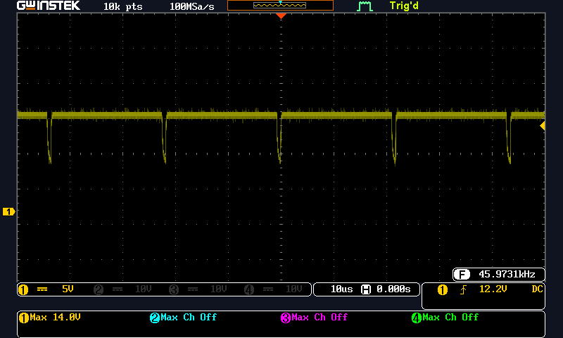

  • Hi Colin,
    Yes it is confusing and nonsense. Therefore I have changed the conroller with a new one and everything is OK now.
    I have completed all the checks above everything is OK. I have applied AC and there is no problem except I could not get output above 336VDC.
    At around 100VAC output reaches 336VDC and never changes. Load is around 0.2Amps.
    I have checked Vsense it is around 4.3V
    Below is the signal at gate.
    Do you have any suggestion for increasing output DC level?
  • Hello Mert
    The controller may be going into current limit so I'd suggest you double check the connections to the current sense resistor. The current sense resistor calculation is one of the steps in the Excel calculator for this product. Double check the sensing connections to this resistor - it's easy to pick up enough stray mOhms in the connections to significantly increase the effective value of this CS resistor. Run 1A from the bulk capacitor negative to the -ve terminal of the bridge rectifier and measure the voltage between the ISENSE and GND pins of the IC - does the measured resistance correspond with the nominal resistor value.
