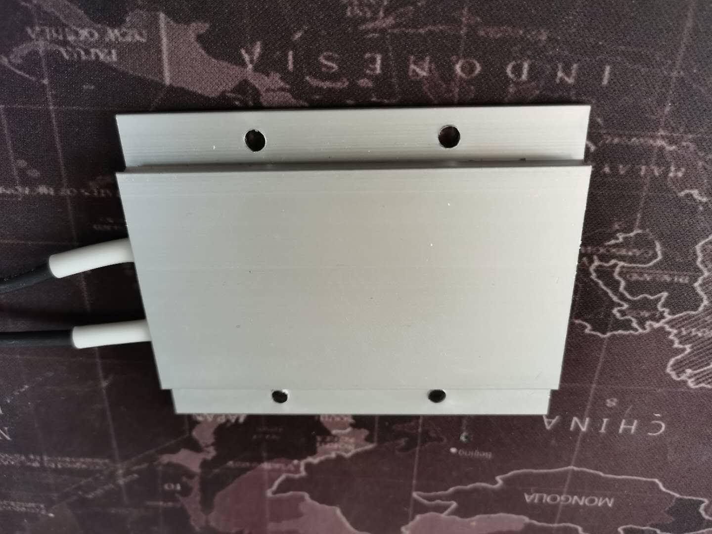

          1). PTC is my load and I use it to heating board. It is a constant power element about 13.5W . Its internal resistance is 6 ohm at room temperature(25℃) and 34 ohm at 80 ℃.

    This is my load PTC. It is a variable resistor at 6Ohm@25℃ and 34Ohm@80℃.

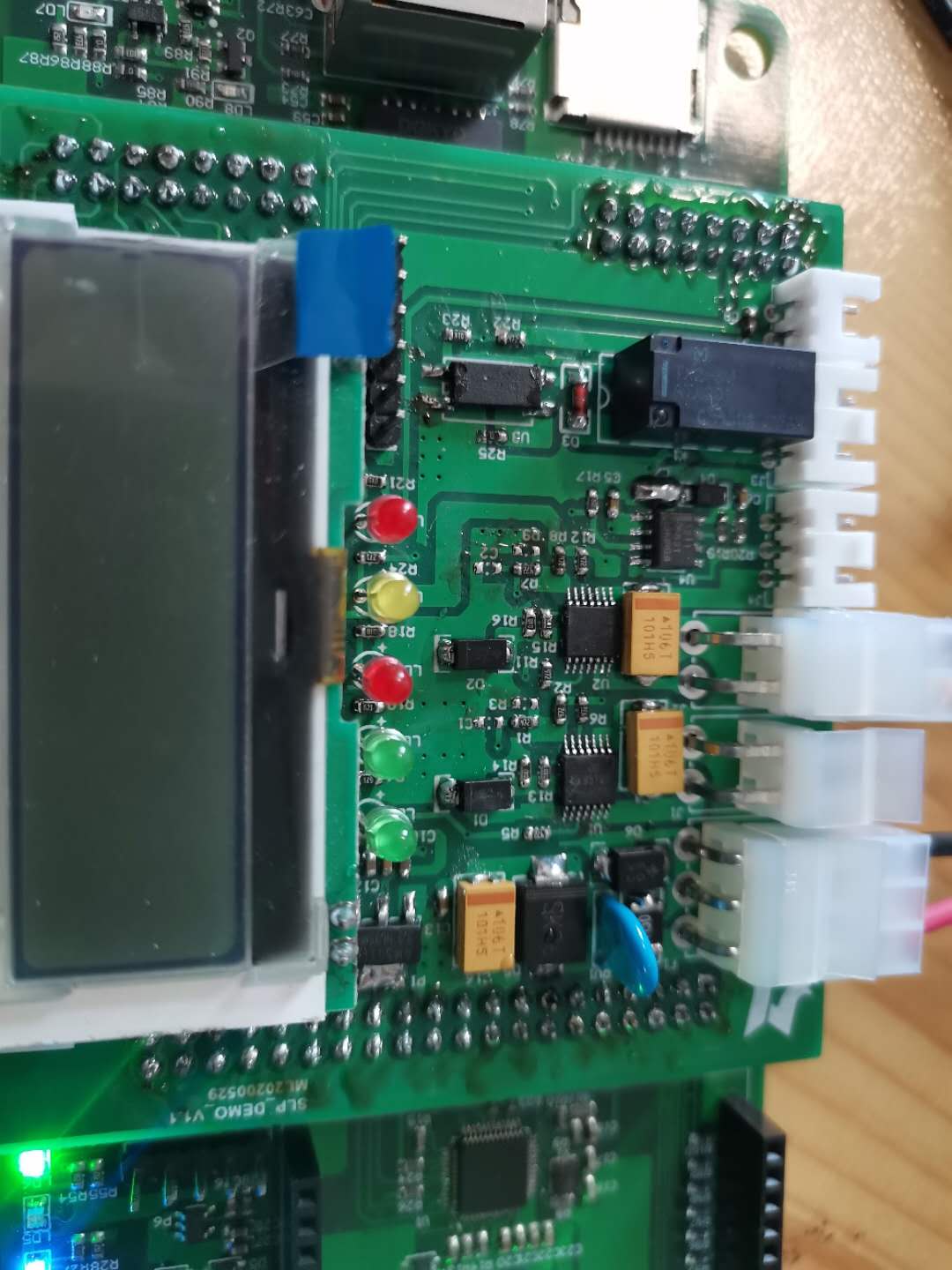

    This is my board and I ues two pcs TPS1H100A, one is to drive motor and RCL=1K, the motor is OK. The other is to drive PTC and RCL=510Ohm, the PTC doesnot work well.
    I use a 24VDC@300W switching power supply to power my board.

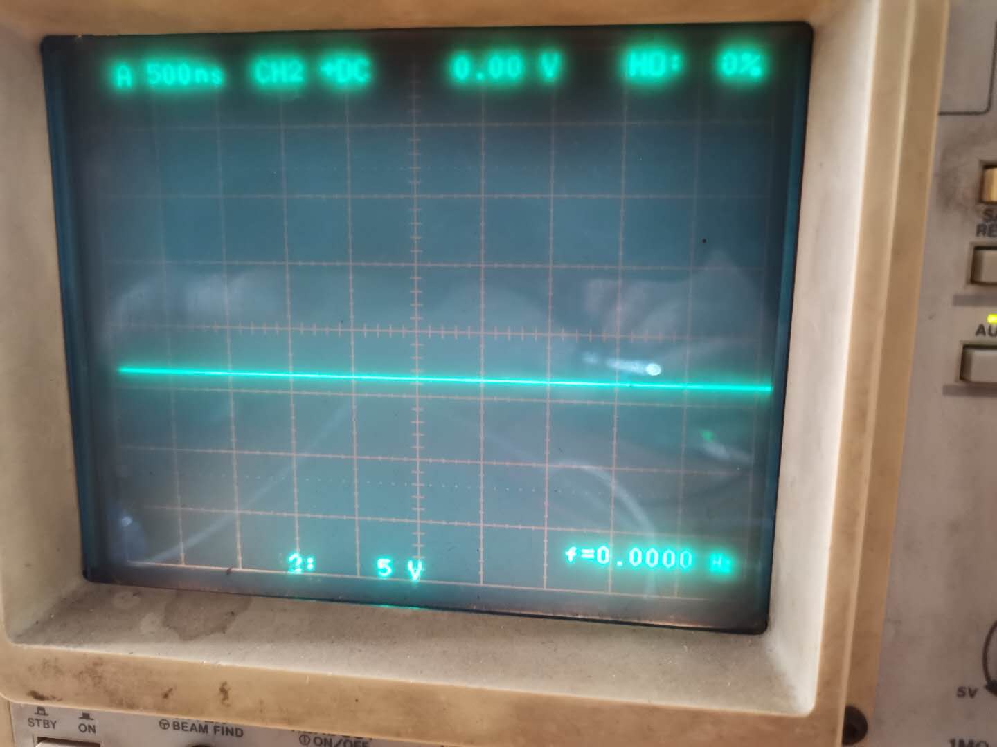

    This is GND waveform.

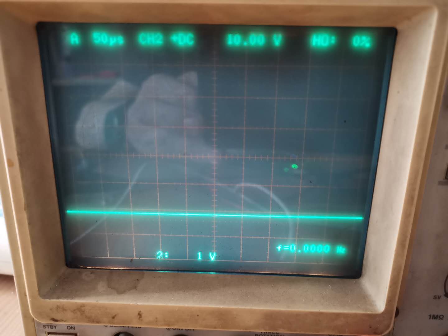

    This is out wavefrom. When it starts,no load condition, I set IN=1, VS=24V. When the load is applied,you can see Vout=6.4V(Iout=1.7A), ST=0 and VS=6.4V, the PTC does not work well.
    After about 20 minutes, when the temperature of PTC rises, the resistance of PTC increases,  the Vout will rise to 24V(Iout=0.6A) , VS also rise to 24V and ST=1.

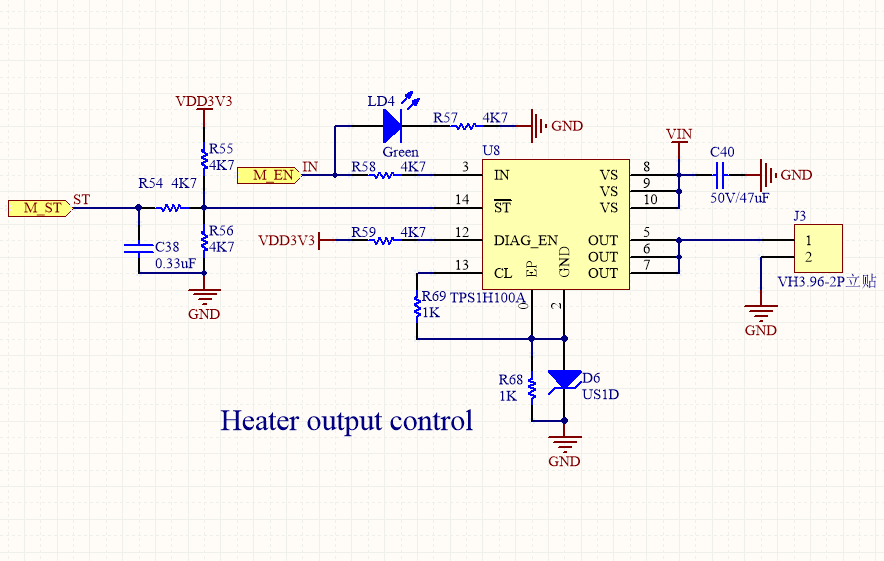

    Awesome, appreciate the waveforms. Do you have a schematic you can share?

  • Hi Anthony ,
    This is my SCH and R56,C38 is NC.

  • Hi Ivan,
    Thanks for answering the questions
    Do you have a complete schematic of the board or can you answer if there are capacitors connected to J3 anywhere else on the board?  If there is a concern for confidential information, we can continue this thread over email (a-pham@ti.com).
    A 1k resistor correlates to a 2.466 A current limit. How are you measuring current? You mention that the PTC is 10 Ohm at startup at the beginning of your post, what is the current at startup? Is the device still hot now that you've changed the resistor?
