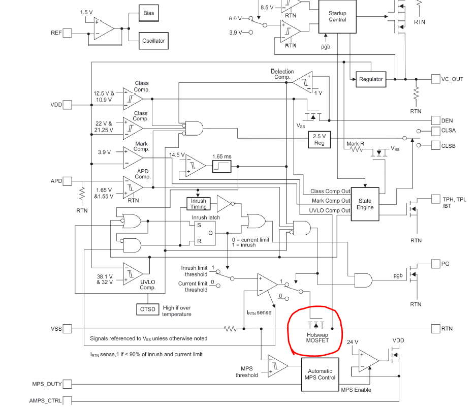

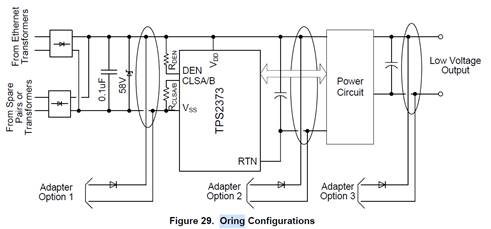

Nice to meet you. I receive a question about TPS2373-4 using adapter oring option 1 configuration.
My customer wonder if use the "Adapter Oring" function optional 1. How is the internal hotswap MOSFET statue? Will this MOSFET in ON state and keep a typical Rdson=0.1Ω?
    From datasheet section 7.4.9 PD Hotswap Operation:
    The hotswap switch will be forced off under the following conditions:
    1. VAPD above VAPDEN (approximately 1.65 V),
    2. V(DEN –VSS) < VPD-DIS when V(VDD-VSS) is in the operational range,
    3. PD is over-temperature, or
    4. V(VDD –VSS) < PoE UVLO falling threshold (approximately 32 V).
    So if the customer is using an adaper, APD > VAPDEN and the FET will be turned off. So it will be high impedance.
    If the customer is using PoE, then the FET will turn on.

  • Hi Michael,
    Thanks for your reply!
    Sorry I didn't understand it. If the MOS is turned off, the adaptor will be disconnected from the circuit. If adaptor disconnect from the circuit, how to power the system in that case?
    Thanks!
    B.R.
    Zhizhao
  • I am sorry I misread your question.
    If you are doing option 1, the Hotswap FET will be on.
    The following paper goes into more depth in the PSE and Adapter Input OR-ing options.
