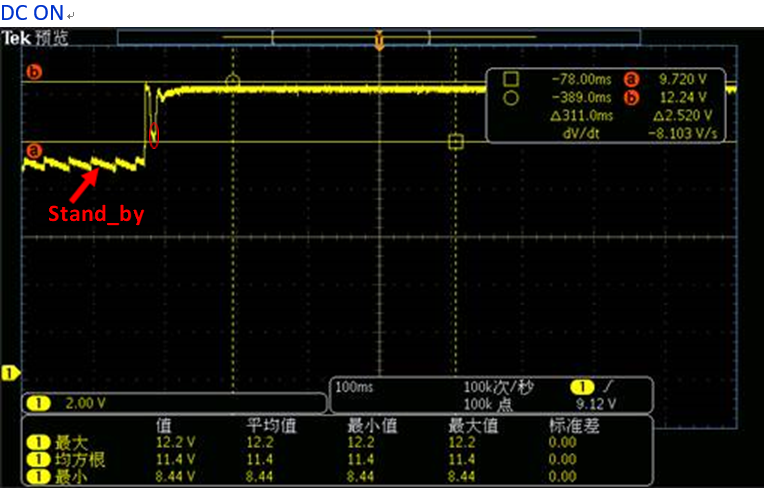

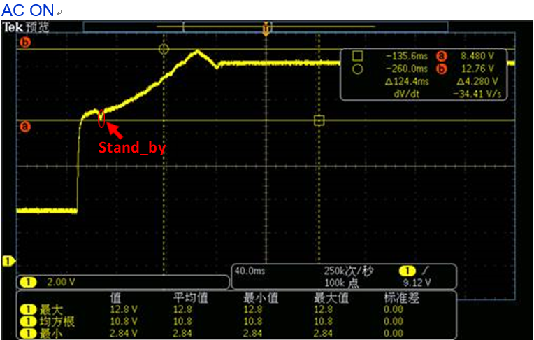

Hi Sir,
 My customer would like to design TPS563201 on the monitor. The Vin voltage is 12V from ACDC module.
Due to the power up loading has the sequence, so the ACDC side will has the drop voltage behavior on as waveform showed during ACDC change from standby power to 12V.
Would you please review following waveform in the monitor AC ON and DC ON? Any electrical risk or performance concern on TPS563201 Vin drop voltage at power up stage?
