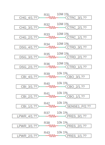

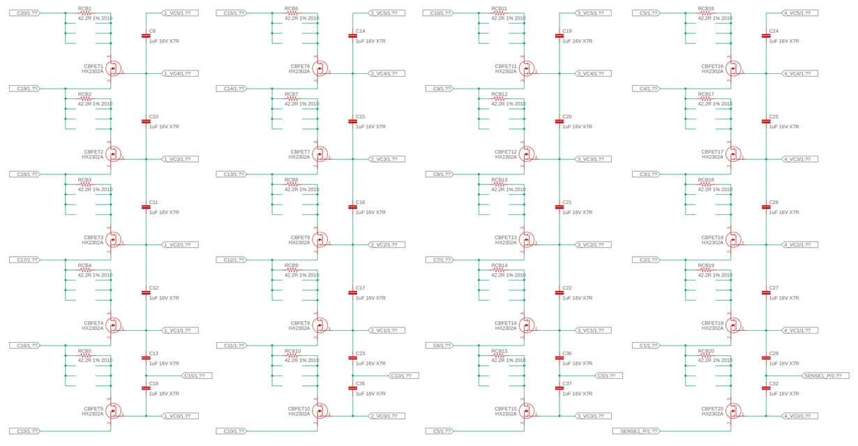

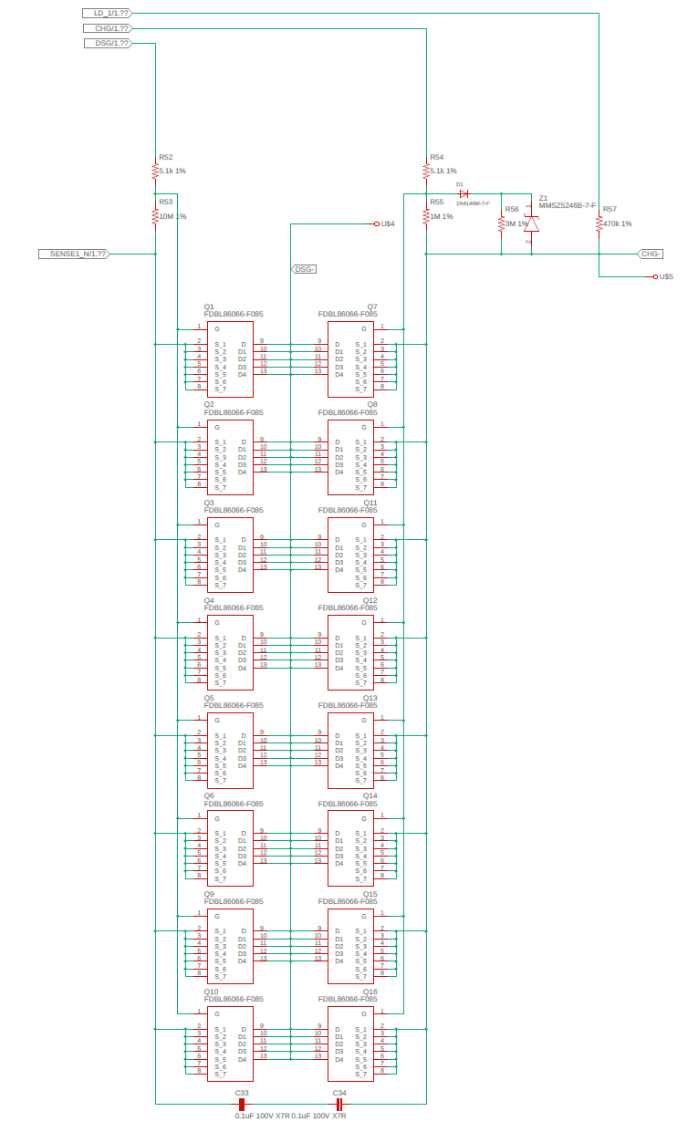

I completed my schematic for my project: 20S 80A PCM.
But my completed PCB does not work.
I upload my schematic for reviewing them.
Please give me how to solve this.
I already checked my missed circuit, LD for upper ICs and added to on PCB by hand wiring, but still not work for DSGfet.
Charging is work well but Discharging is not working.
