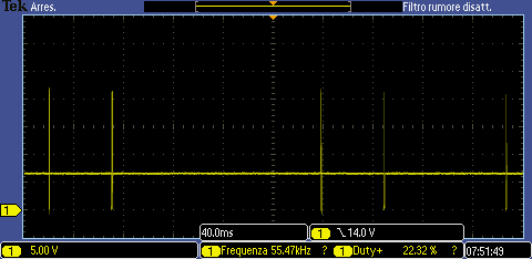

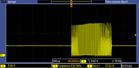

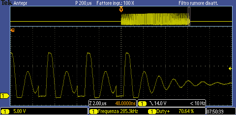

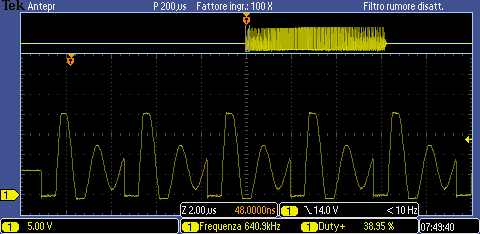

    The peak current in stable status is around 2.9A. Can you measure the waveform of SW to identify the root cause?

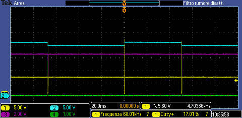

    as required I attach waveform.

  • Hi Charles,
    below I report the waveforms as required:
    Ch1 = SW
    Ch2 = Vout
    Ch3 = Vin
    Ch4 = FAULT
    PWM is set to 100%
    Not having the current probe for the oscilloscope, I zoomed in on the SW signal, so through the Rsd (on) value of the FET we can trace the current indicatively.
    From the curves I note that the problem is the decay of the measured input voltage measured on the capacitor C55. I also tried to increase the value up to 470uF but I don't solve it.
  • Hi Davide,
    I think the voltage drop on the L5 and FB1 is big when the input voltage is low and output voltage is big(The input current is big at this moment). You also need to consider the voltage drops on the input wire if it is long. UVLO is triggered according to your waveforms and device need to restart in this condition. That is why the output LED flashes. Maybe you need to change the L5 and FB1.
