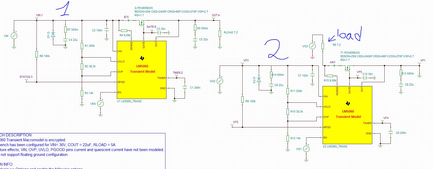

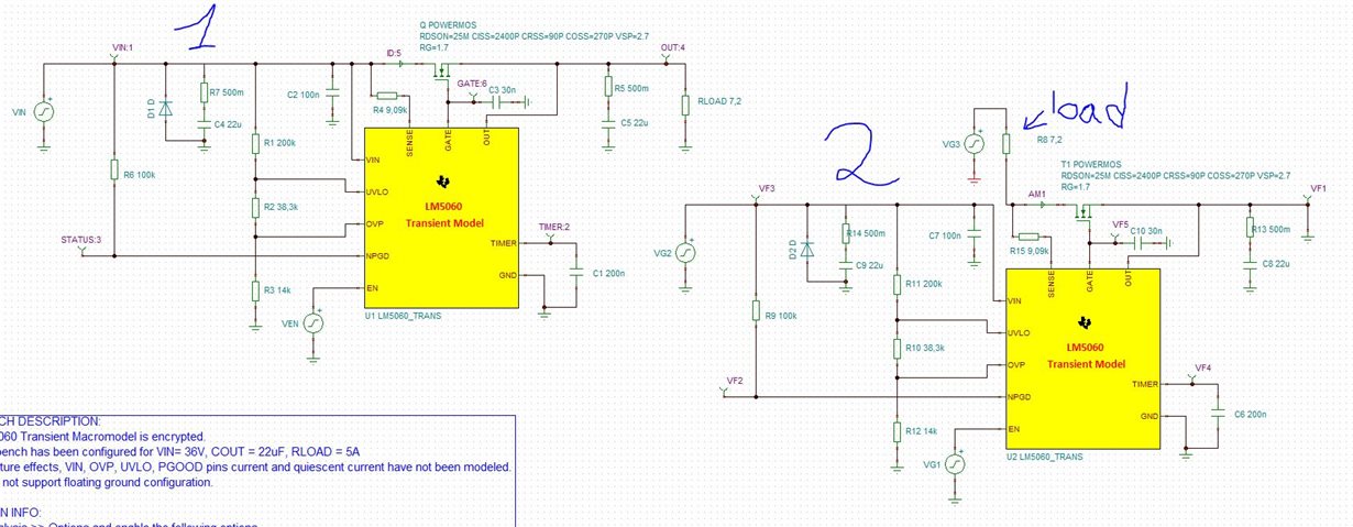

For our particular application it would be interesting to place the eFuse at the low side of the load, and power the IC with a separate voltage source, via de Vin pin, with common ground. I attach a small schematic, of the original reference design, and our idea.
As i couldn't manage to find any examples or eFuses designed for use in a low side configuration, i was wondering if it is possible, and why i couldn't find any.
