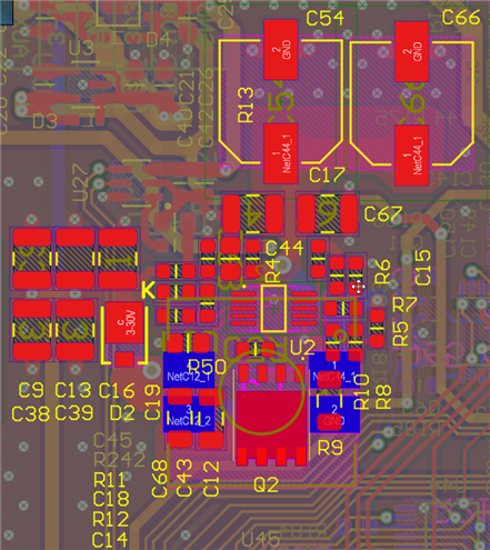

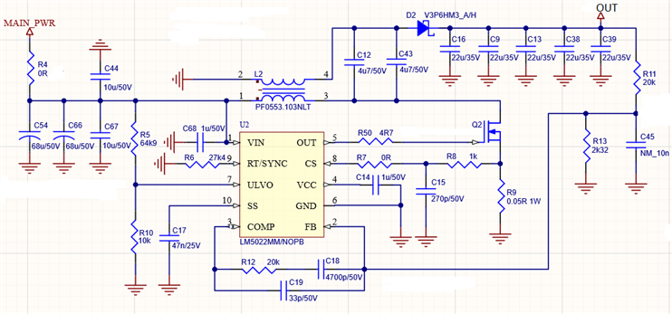

I have built sepic converter based on www.ti.com/.../PMP7305
Unfortunately Q2 burned up few seconds after power up. Before that I was able to measure output voltage - it was something about 60V without any load.
This is how my design looks like:

I'm going to replace Q2 but before that I have few questions:
1. Do you see any errors in above schematic and/or PCB?
2. Are there any steps that should I do when I will run it again to prevent burning up again?
  •  R11/R13Hello Tadeusz,
    seems the loop is not closed, so the system is not going into regulation.
    Via softstart duty cycle increases to maximum, output voltage goes to maximum.
    Stress at FET and rectifier becomes Vin + Vout, FET blows up around Vds 66V to 72V.
    Fits to your description above.
    Check your feedback divider R11/R13 and check compensation R12/C18/C19;
    please check values AND connection. At feedback pin #2 you need to measure
    reference level 1.25V in regulation.
    This would be my very first action item, best regards, Bernd
  • Hello Bernd,
    You are right - there was no connection from divider R11/R13 to feedback pin. So short wire fixed this issue.
    Many thanks.

    thanks for suggestions - I've already replace all outputs components and it works however I see much bigger voltage spikes on output that it is shown in reference design test results (page 4): www.ti.com/.../snvu121.pdf
    Do you have any idea how to fix this?
    Tadeusz

    If you need to reduce the noise:
    - main topic, 100% perfect layout
      shortest loops, input/output caps back-to-back, small switch node area,
      no corners at switch node polygon (corner is a wideband antenna),
       solid ground plane
