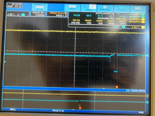

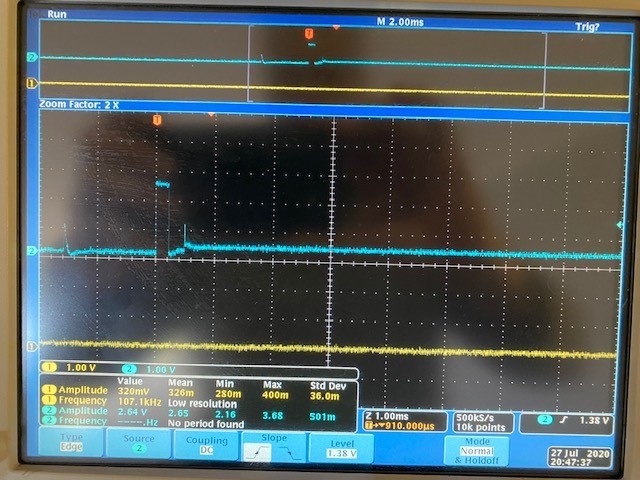

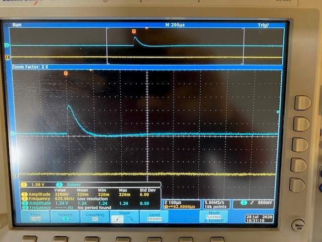

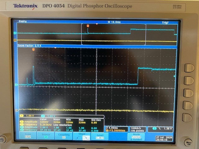

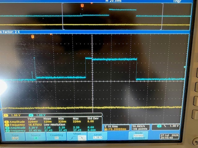

Hi All
I am having an issue with the BQ24075 on a new design. Please see the schematic below - R4 is not fitted, so max In Current is set to 500mA. When we plug the USB in, the PGOOD and GHG pins pull low as expected and the USB Inrush Current test waveform occurs at the ISET pin as per the datasheet. However, the charge current drops to less than 20mA and the battery does not charge properly.
