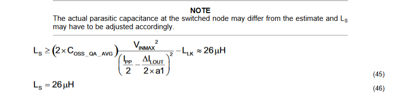

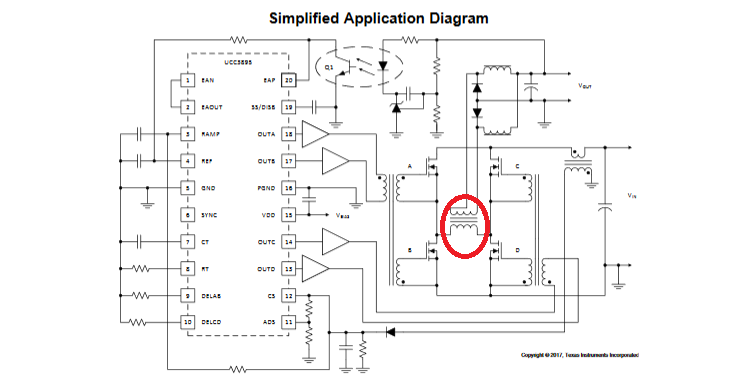

Hi Team
Good day
Our customer have a question that , in the  UCC1895 /2895/3895 datasheet page 28 . there is the formula 45 , the customer need to know  [Llk]  value . I had check the datasheet , I did not find any information about it . Could your provide any help?
