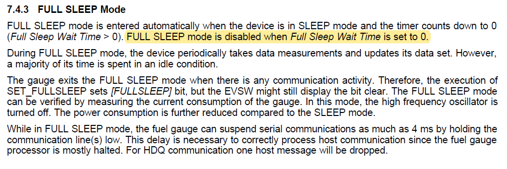

  • The bq34z100-g1 device has three power modes: NORMAL mode, SLEEP mode, and FULL SLEEP mode. The FULL SLEEP mode can achieve the lowest power consumption.
    See Chapter 5 fo bq34z100-g1 TRM for more details.
    Andy

  • Yes. The correct parameter is called "FS Wait" in the bqStudio.  By default, it is 0, which means the FULL SLEEP mode is disabled. You need to set it to a non-zero value to enable the FULL SLEEP mode.
    Andy

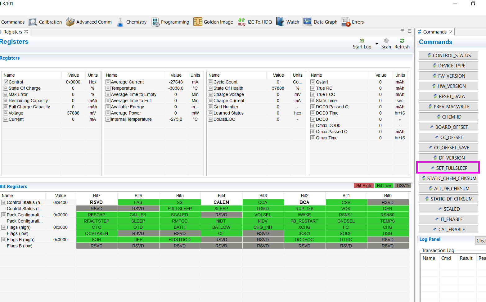

  • Hi Wyatt,
       Thanks for your feedback.
        I can help to scope the commands for the customer.
        There is one more question about "disable FULLSLEEP" command.
         We only can see the "Set_FULLSEELP" command in bqStudio while cannot find the command to disable it.
        Would you kindly to advise?

  • Hello Edward,
    This command should enable the FULLSLEEP functionality, but to see if the gauge has entered that full sleep mode you have to check the current consumption as stated in section 5.3 FULL SLEEP Mode of the TRM.
    It will have to transition from SLEEP mode to FULLSLEEP mode, you should see a decrease in current consumption.
    It doesn't look like there is an easy way to tell if it is enabled or disabled from the registers. If the full sleep wait time is set to 0 it is disabled.
