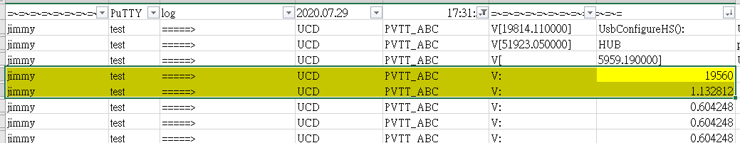

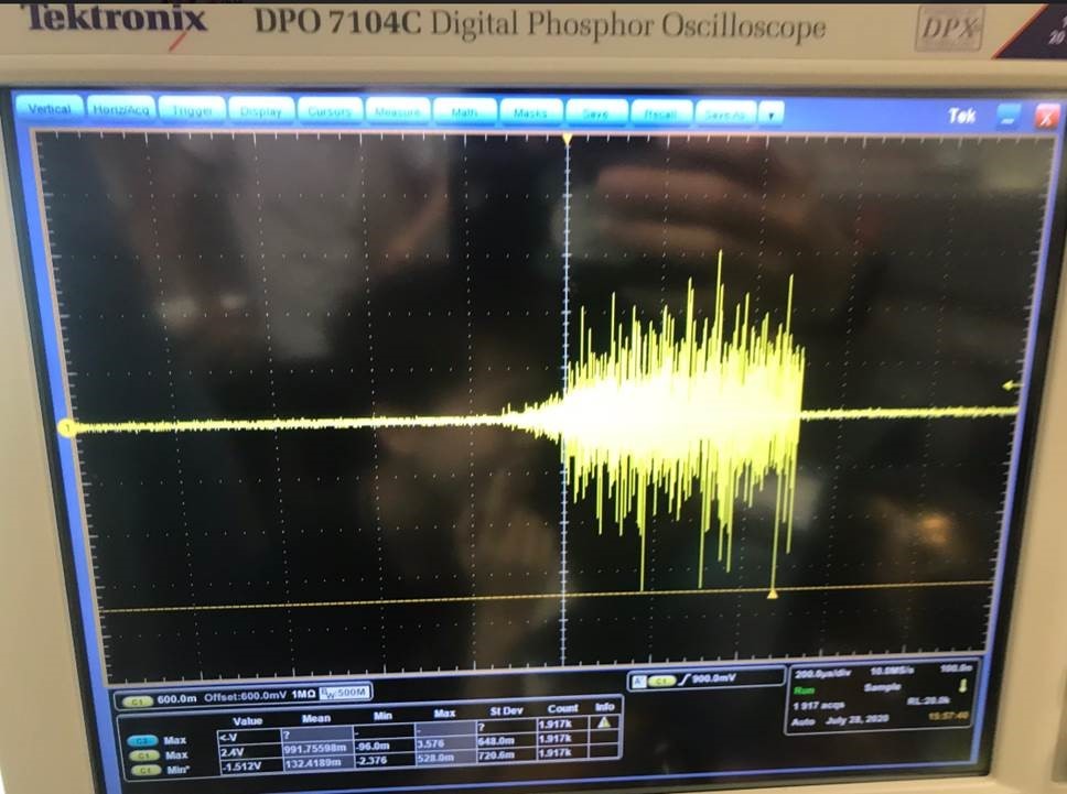

    I use machine to measure signal. The same time I, I use Fusion to monitor the signal, But it's not like. And my polling rate is adjust 1ms, can't be smaller.
    PVTT_ABC (max = 2.4V, min = -1.512V, continue 500us)
  • Hello
    Negative voltage is not support. The ADC is not continuously sampling and it sample at spots with intervals. So if you want to test the accuracy, you have to have a good signal instead of something like noise.

    Can the software(Fusion) and USB interface Adapter both record every data(PVTT_ABC)?
    Save like to *.txt.
    The picture below is recorded with BMC.

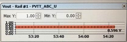

    Now I use Fusion to monitor voltage, and not find wrong voltage, But use BMC to get voltage have wrong voltage. BMC is use comment to get voltage.
  • Hello
    First please make sure that BMC interprets the data correct. Please refer section 4 of https://www.ti.com/lit/pdf/slva385
    For the GUI, you can enable the PMBUS data logging(Tools->PMBus logging). the data will be saved into a file.
