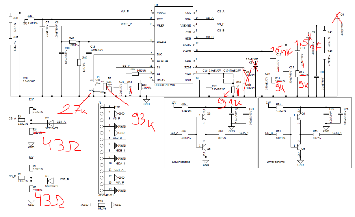

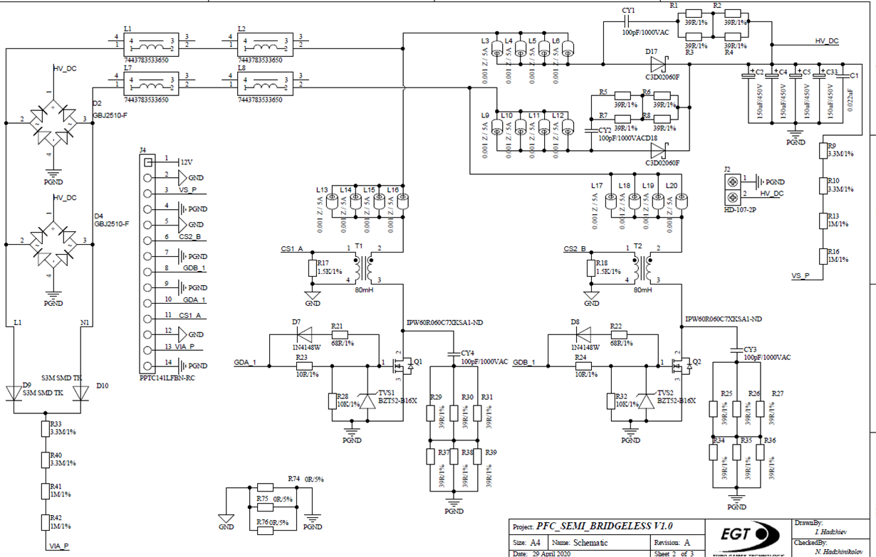

I have designed two semi-bridgeless PFC - one that works on 200 kHz and one on 90 kHz.
The one that work on 200 kHz is just fine, but i have a problem with 90 kHz design
I have attached schematic with the input voltage and load conditions.

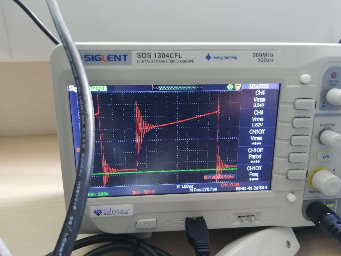

the oscillograms shows  the inductor current and it seems like the inductor is going to saturation - the input rms current is 5,45A and inductor peak current should be 7,7A, but it jumps up to 10,7A  also the inductors generate noise that i can hear.
I have attached the input current diagram and also the output voltage is regulated fine i have tested it on various loads. I have to mention that there is no saturation with 230V input.

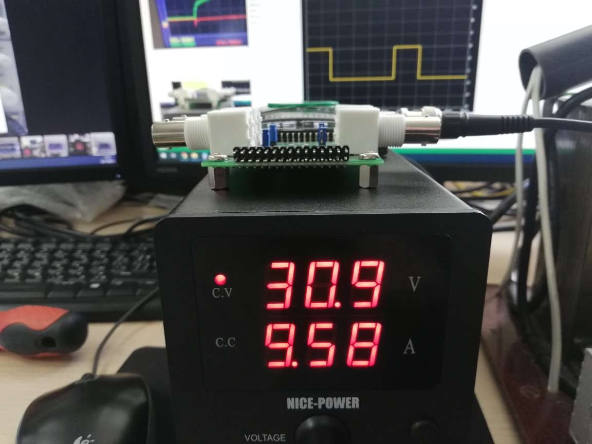

    the problem is not with the filtering capacitor also i tested the inductor magnetic and there is no saturation on 10A RMS ( attached picture )

    The schematics are attached also:
  • Forgot to mention the inductors that i am using are not those that are written on the schematic,  they are custom made and the inductance value is 260 uH
    Inductors saturate with DC voltage.  I thought your inductor were saturating because there was something wrong with the timing.  If V1*t1 when the inductor is being energized is equal to (Vout-V1)*t2 when the inductor is deenergizing the inductor will not saturate.  You have verified the inductor is not saturating.
    You have a picture with a box showing a constant voltage of 30 V.  Is that a constant voltage load?
