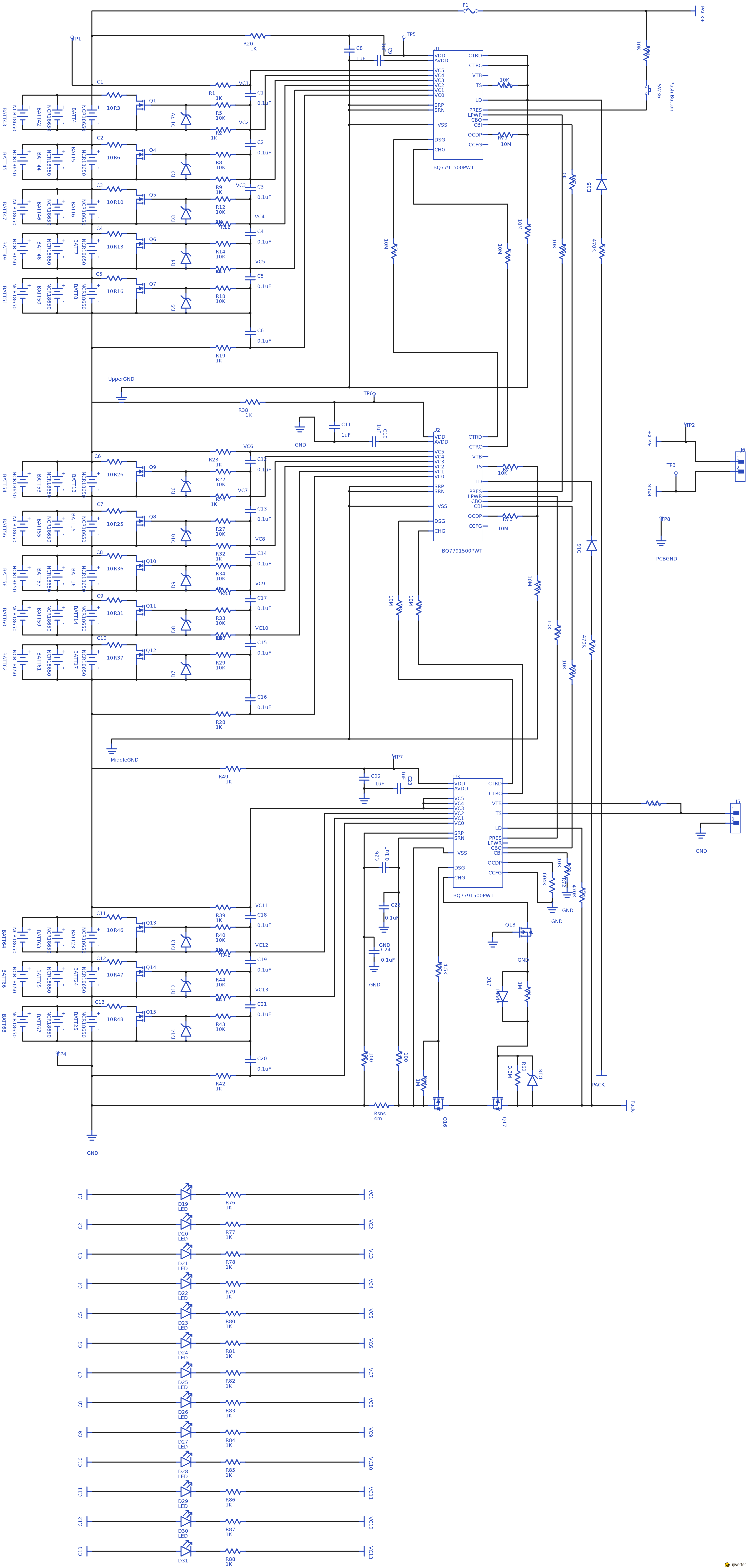

Kindly review my schematic design for 13S 10A specification.
Please provide feedback.

  • Hi Shivani,
    I see some things that need to be corrected in the schematic. I recommend you make these corrections and send the new version back for review once more:
    • The same Gnd reference cannot be used for each device in the stack. You should have a Gnd, Gnd_middle, and Gnd_upper. Please refer to this BQ77915 stacking app not for an example schematic: https://www.ti.com/lit/an/slua906/slua906.pdf
    • R54 (LD pin resistor) should be 470k (instead of 470)
    • There are components missing from the sense resistor pins. Please see section 10.2 in the datasheet - there should be series resistors and filter capacitors included (https://www.ti.com/lit/ds/symlink/bq77915.pdf).
    • The bottom device is configured for 3 cells. This should use VC0 - VC3 for the cell connections. See datasheet figure 9-11 for an example connecting 3 cells.
    Make sure the refer to the datasheet example and the stacking app note example to double-check everything. Then send it to me once more and I can help look at the final schematic.

  • Hello Matt,
    Thank you for quick response. Please find the updated Schematic with all your comments fixed.
    Kindly request to review.

  • Hi Shivani,
    This looks much better. I checked with a colleague and they suggested connecting 5-4-4 cells to each device (5 to top device, 4 to middle, 4 to bottom device) as a better option to 5-5-3 to distribute the cells more evenly.
    Also, it is not clear if the middle ground and upper ground are connected to the right point. They should be connected to the bottom of the lowest cell in that group.
    Matt
  • Hello Matt,
    As per your recommendation, I have changed the cell distribution to 5-4-4 pattern. Kindly review the final schematic. Also, let me know if the fuse position and the LEDs for cell balancing are correct.
    The middle ground and upper ground are now connected to lowest cell in that group via flag (Schematic limitation). Please let me know if this is correct.
    Also I want to know the maximum current BQ77915 can support.
    Shivani GhorpadeSchematic_3.pdf
  • Hi Shivani,
    The ground connections are correct. The LEDs are not needed - these are only included on the EVM to help the user see that balancing is working while evaluating the device. They are normally not included in a real battery.
    The fuse placement looks okay.
    Matt
