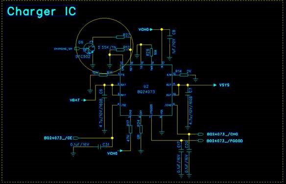

BQ24073: Whether the charging current can be changed.
Part Number: BQ24073
Hi TI,
I want to set the charging current differently depending on the temperature.
A circuit that synthesizes parallel resistors with TR was constructed. See circuit below.
Is there any problem changing the ISET resistance value during charging?
Does the charging current change when the resistance value is changed during charging?
Please check it..
