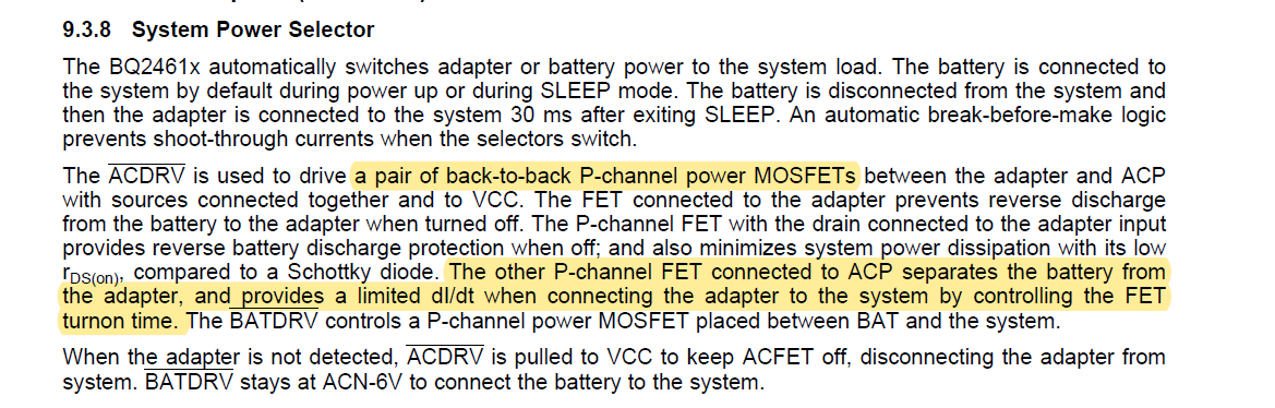

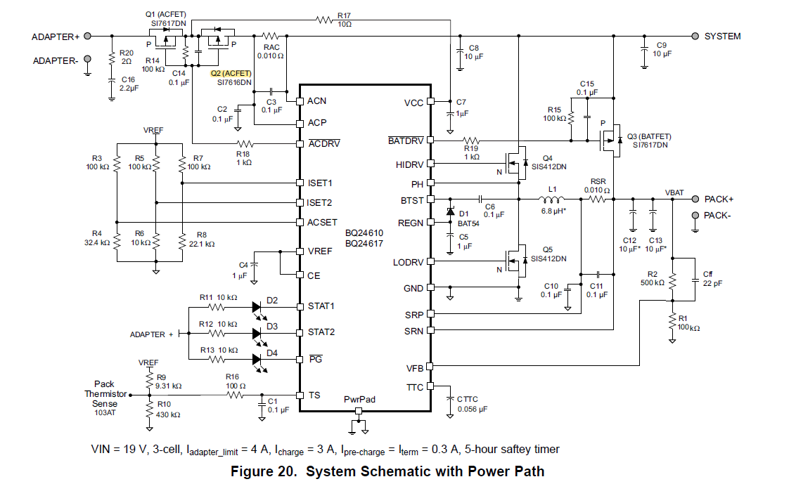

As shown in below picture, here two questions I wondering to know:
  • What effect does the di/dt of P-MOS has on the system?
  • Why separate the battery from the adaptor?
Thanks a lot.
  • Hi Chester,
