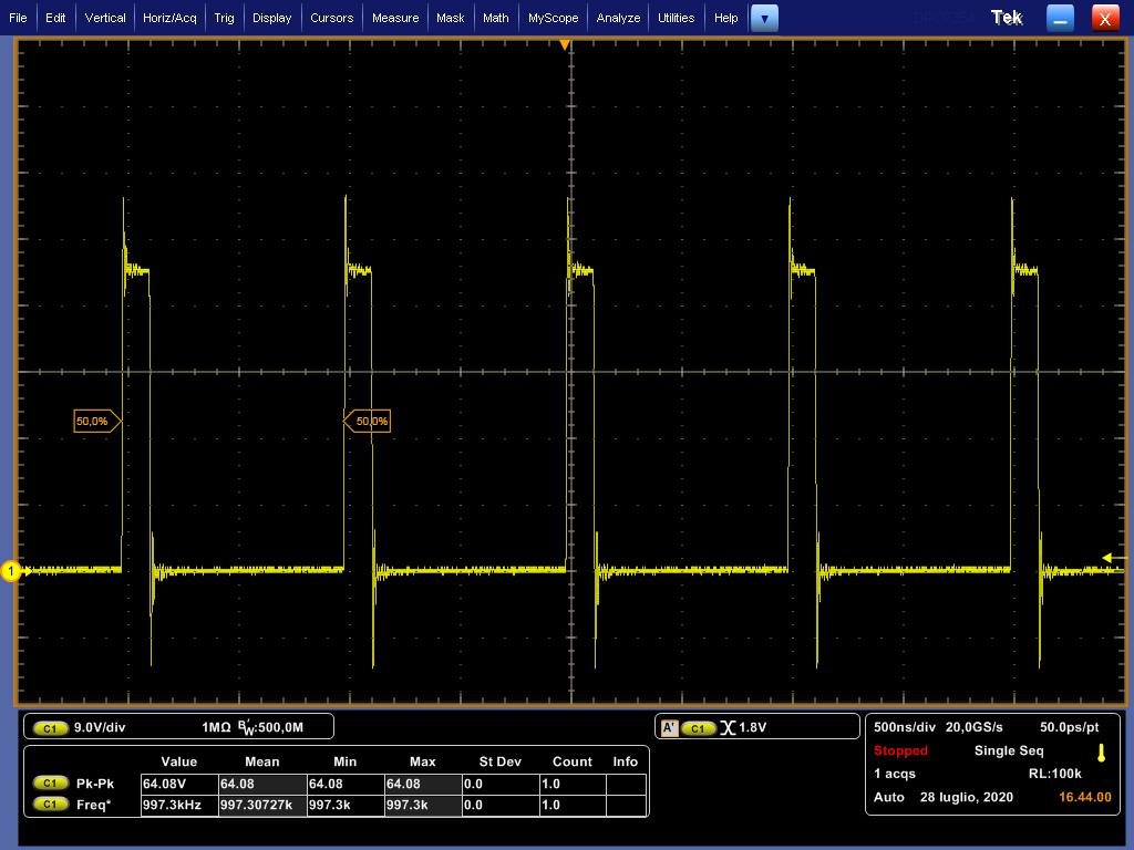

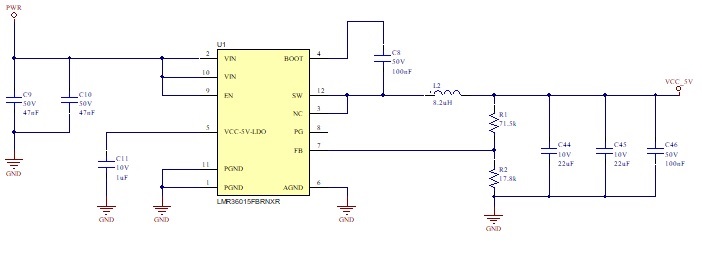

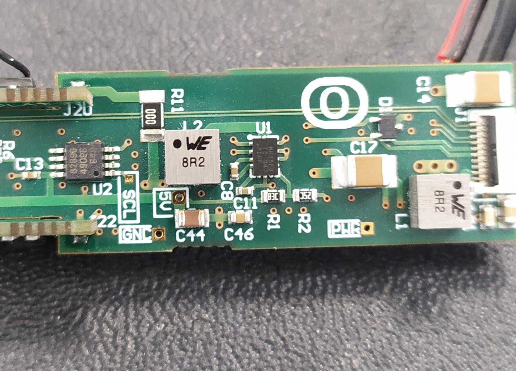

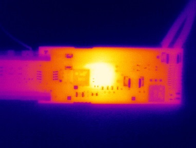

I'm debugging a board with the power step-down LMR36015. Following the schematic that I used. I'm facing a strange high-temperature chip value even if without any load when I power the device with 40Vdc. the temperature rise up to 70 degrees. The output is stable. I also attach the signal on the inductor. What could be the reason?
  • Fabio,
    It seems like there is not enough copper around your IC.
    See datasheet section 9.2.1.2.10 and Figure 19 about the importance of copper area around the IC for thermal dissipation.
    Also see the layout guidelines (11.2). The copper planes around the GNDs (pins 1, 6, 11) are important for heat sinking.

    thanks for the reply. As you could see I have not so much space around (in fact there are components on the other side and vias are reduced, I know). But thanks for the suggestion, if this is the solution I will investigate how to change this. For evaluate all the possibilities, could you reply me on these questions?

    Absolutely. A FPWM converter will always be switching at full frequency, even at light load / no load.
    A converter using discontinuous conduction (DCM) would not be switching at light-load so would experience less heat rise at light load.
