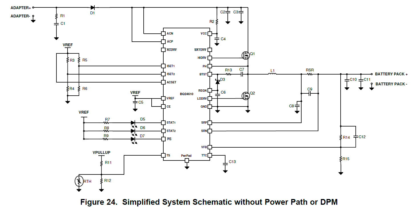

  • Simplified system without PPM as shown in below picture. In this simplified system, can the adaptor power the system load?  If it can, and how to power?

    • Simplified system without PPM as shown in below picture. In this simplified system, how do the battery and adaptor power the load?

  • Chester,
    In the simplified schematic, without Power Path or DPM, the system would be powered directly from the battery pack.
    I hope this resolves your issue,
