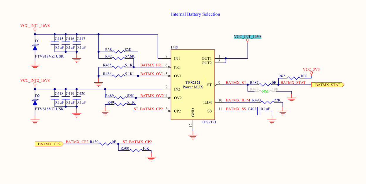

We have added TPS2121 in our camera system to switch between 2 16.8V battery packs one among which powers our system at a time.
VCC_INT1_16V8: Battery Input 1
VCC_INT2_16V8: Battery Input 2
VCC_INT_16V8: TPS2121 Output to 3-Channel Power Mux Battery Input-1
BATMX_CP2: 3.3VIO GPIO signal controlled by processor.(Initially 0V due to pull-down).
We observed that when only the Internal batteries are connected to the system, the system is not powering up.
As we inspected, found that VCC_INT_16V8 is between 4.5V and 5V only.
We ensured that VCC_INT1_16V8 and VCC_INT2_16V8 are both between 15V and 16.8V.
The voltage at CP2 was 0V.
The ST pin was LOW.

  • Hi Emil,
    Could you please provide scopeshots that describe this issue? Is this event repeatable on more than one TPS2121 device? Does this only occur with the internal batteries connected or do other sources cause this drop in voltage? When you have external sources connected does the system work as intended?
    I also am unable to figure out your CP2 circuit. Where does the BATMX_CP2 node come from?

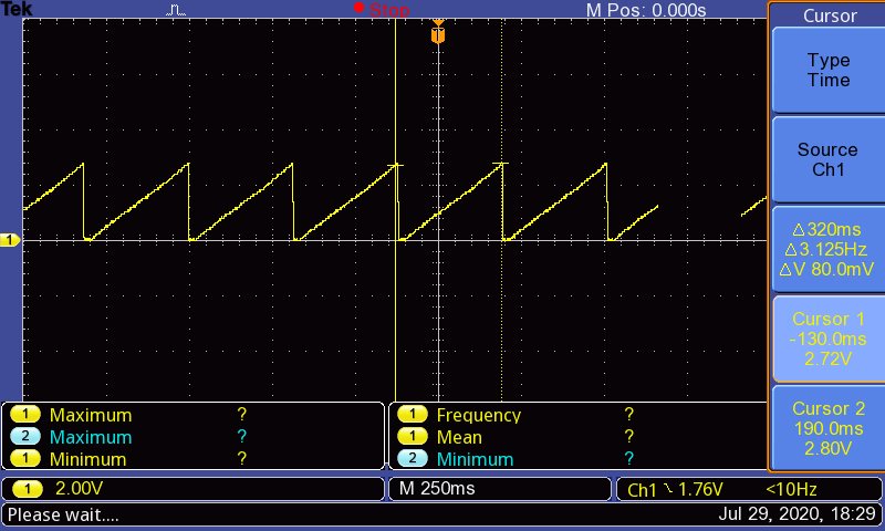

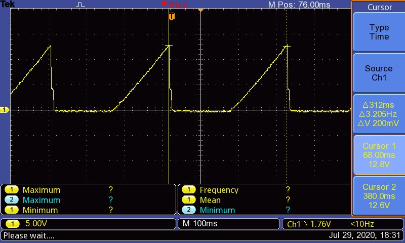

  • Hello Shreyas,
    We probed the voltage at SS and VOUT pins and noted that the voltage is switching there.
    At SS pin, the voltage is toggling between the around 13V and 0V at a similar frequency of  3.205Hz. This was when we used 1uF capacitor for SS.
    Earlier, when we used 0.1uF cap, the switching frequency was higher.
    At VOUT pin, the voltage is toggling between around 3V and 0V at a similar frequency of  3.125Hz. This was when we used 1uF capacitor for SS.

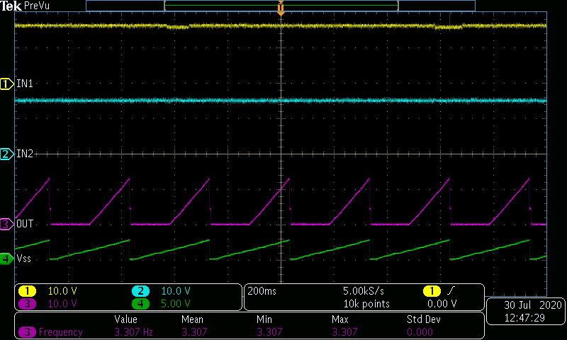

  • Hello Shreyas,
    Please find the waveforms.
    IN1: Internal Battery Input 1
    IN2: Internal Battery Input 2
    OUT: TPS2121 Output
    Vss: Voltage at SS pin
  • Hi Emil,
    Thank you for the waveforms. To me this eliminates any sort of UV or OV fault occurring from the internal batteries.
    Since the system works as intended from external supplies, I believe that your switchover settings are correct.
    Please confirm: OVx is set around 18V and PR1 switchover is set up at around 13V. Your intention is to do manual switching by using CP2 pulled high or pulled low.
    My suspicion is that there may be a thermal event(current limiting) occurring in the device during turn on. Since you have confirmed that this behavior still occurs with only one supply can you re-run the test once more with only the external battery connected to VIN and CP2 pulled low?

    The SS pin is showing that the device is soft starting every "turnon" phase. A current waveform will help us confirm what the device is experiencing during each failed turnon.

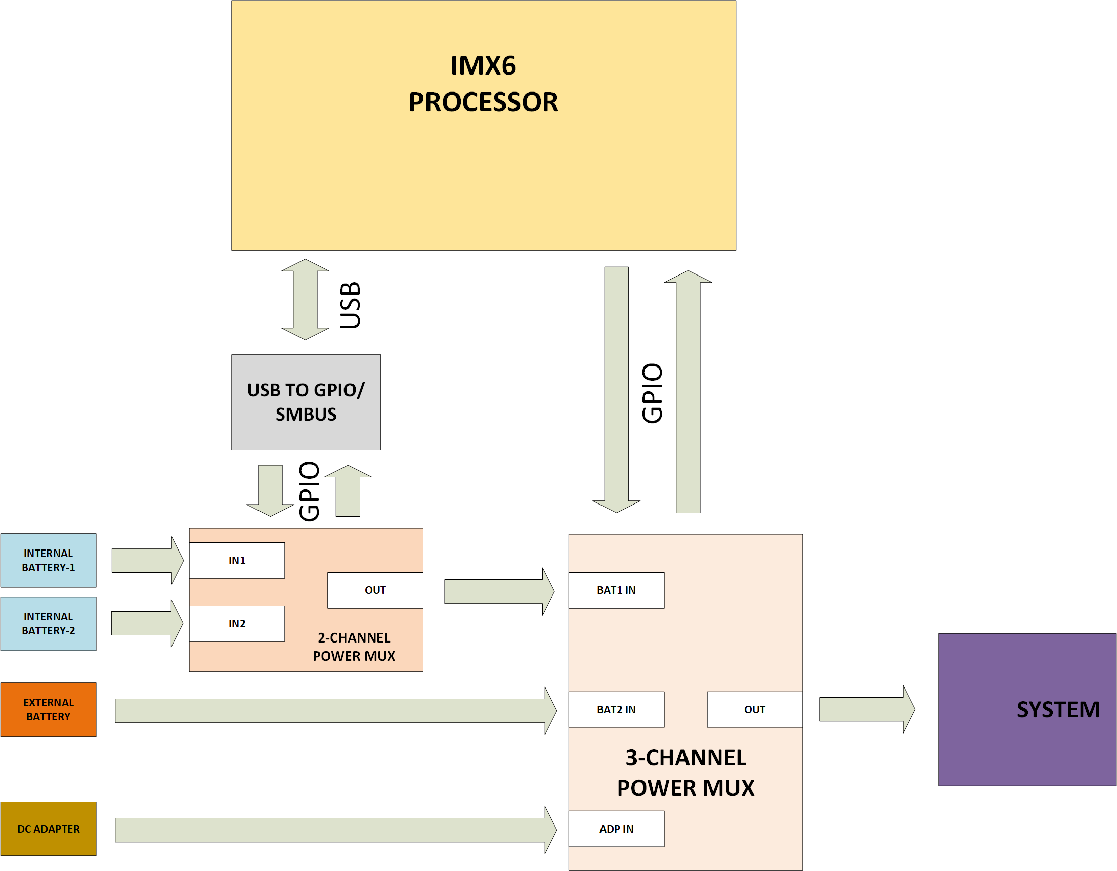

    We have designed for the switchover from Internal Battery1 to Internal Battery2 by driving a logic High(3.3V) at the CP2 pin by our controller. Initially, this pin is pulled low using a 10K resistor.
    We also suspect if it is a current limiting case by the TPS2121. Whatever supplies(battery pack or DC power supply output) if we connect to the IN1, IN2 or both IN1 and IN2 of TPS2121, we can observe the output of TPS2121 is ramping.
    We suspect if the 3-channel power mux to which the output of TPS2121 is connected is initially trying to draw some current and TPS2121 is preventing that and the ramp occurs then.
    Once we connect any power supply or battery to any of the other 2 channels of the 3 channel power mux, this initial current may be drawn from it and so the output of the TPS2121 becomes stable as no current is being driven.

    Does TPS2121 support hotswap of power sources?
    By hotswap I mean, I have an External battery connected to IN1 channel of TPS2121 and an Internal battery to IN2 channel of TPS2121.
    As I have connected the CP2 pin to the processor and have added a 10K pull-down to GND to the same(IMX also drives it low once system powered up), system power up from External battery.
    The customer may randomly remove the External Battery and the TPS2121 should switch to Internal Battery. Will TPS2121 support this?
