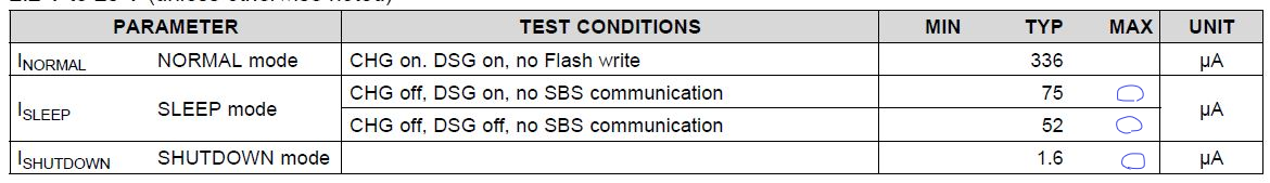

Could you let us know bq4050 SLEEP mode, SHUTDOWN mode quiescent current as shown in circle in below, since our customer needs to know that number for better understanding of this device.
best regards,
best regards,
This data is dependent on when the gauge is sampling the current and voltage data in sleep mode, you can check the TRM states the intervals to measure the current and voltage are adjustable, the datasheet most likely used the default intervals to compute the typical current. You can compare this with the conversion time to estimate the max current.
