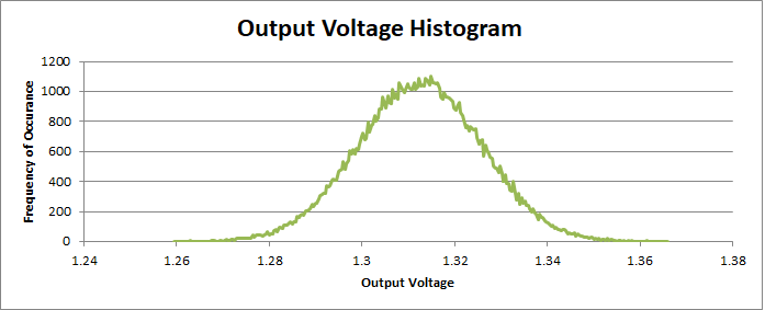

We are using TPS79901 regulator for generating variable output voltages. 180K we are using as R1 and 1.8M as R2 for generating 1.3V output voltage.
For generating other higher voltages we are using parallel combination of resistors in parallel with R2.
We are facing issue in dropping the output voltage at the LDO output. Can you check whether the above feedback resistor values are suitable or not for this LDO.
  • Hi Siburaj,
    Those resistors are fine.
    In most cases any value of resistance can be applied to linear regulators, the issue is the leakage current out of the feedback pin which multiplies against one setpoint resistor and modifies the output voltage.  Since the leakage current is very small in modern LDO's (well under 1uA in many cases) this effect is not always measureable.  In your case the statistical analysis suggests 1.3123V nominal with 13.4 milivolts of standard deviation.  So for a room temperature, sample of one, I would expect a setpoint within 1.3123V +/- 0.0134V.
    What voltage are you seeing instead of 1.31V?
    Can you review the board and make sure it is clean?  Be sure that there are no leakage paths due to flux from soldering on the board.
    Are you measuring the output voltage without a load current attached?  With a load there will be an IR drop on the PCB, which can lower the measured setpoint.
    The statistical analysis as plotted in a line chart is shown below.
    - Stephen
