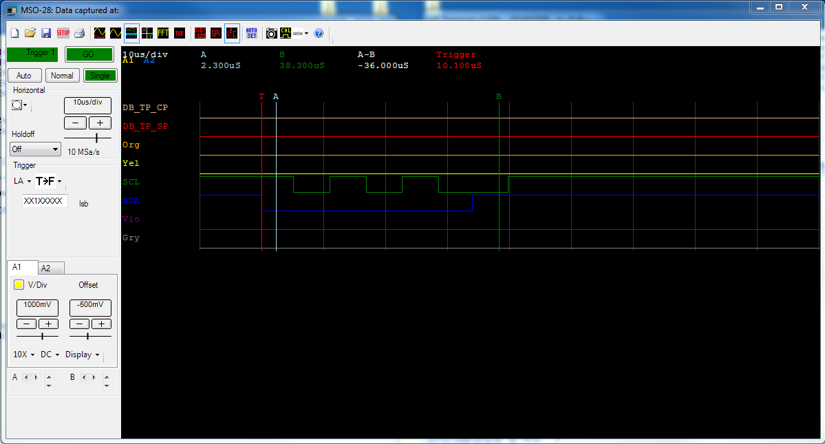

Based on the answer to that question, we wrote the unjammer and included it in our code but as we test our completed system, we need to prove that the unjammer is effective. This means that we first need to be able to JAM the I2C interface of the Battery Gauge. So I wrote some code that bit-bangs out an I2C "Start condition" followed by a few Address Bits but then leaves off in the midst of that I2C transaction. Here's a 'scope shot of that code running:
This jams some samples of our Battery Gauges (such that subsequent attempts to do I2C transactions with the gauge fail until we do the recovery procedure) but not other samples.

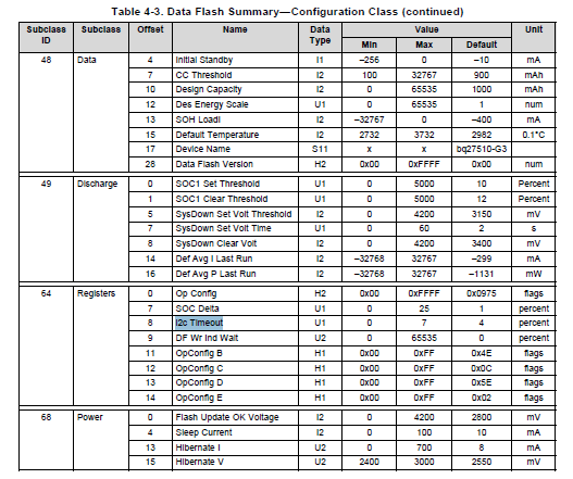

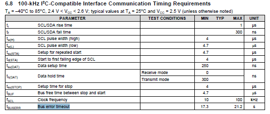

    Also, a new and maybe-related question:
    The Technical Reference Manual mentions the "I2C Timeout" parameter:
    It's stated as a percentage of something and I ASSUME that it's a percentage
    of this Data Sheet value:
    But as far as I can see, none of this is explained further. And I
    wonder if any of this feeds-in to my question of why my gauges
    generally won't jam.
    BTW, I THINK we set this parameter to "4" which may mean 0.5 seconds
    (the math works out sorta-kinda close).
    Atlant

    I don't believe we can go into the details of the state machine. They said that the gauge can't "jam" but it's basically abandoning a transaction, and that was the design teams answer to get out of any abandoned transactions.
    Yes this could be related to your question, have you tried adjusting the value to see if this affects your testing? the gauge could be timing out before there are any errors occurring, preventing any jams.
