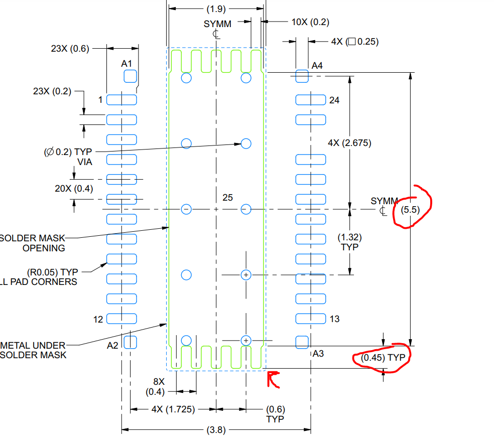

TPS23755: Metal under solder mask Y dimension
Part Number: TPS23755
On page 42 of the TPS23755 datasheet, the X dimension of the dotted line (metal under solder mask) is shown as 2mm. I don't see a number for the Y dimension, is it 6.4mm (5.5+.45+.45)? I'm not sure if the 0.45mm marking goes all the way to the bottom of the dotted line.
