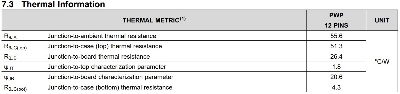

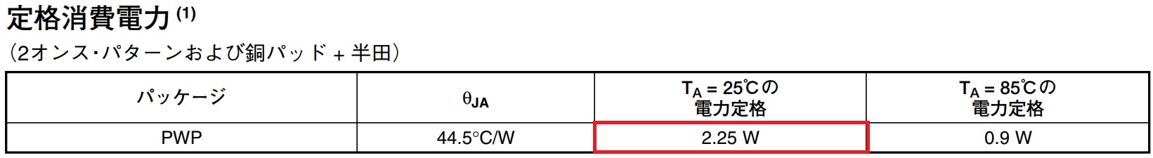

I have a question about the power dissipation of the TPS54325.
The Japanese data sheet states that the power dissipation is 2.25W,
https://www.tij.co.jp/jp/lit/ds/symlink/tps54325.pdf
but In the English data sheet, the description is as follows.
What is the allowable loss of Rev.F?
