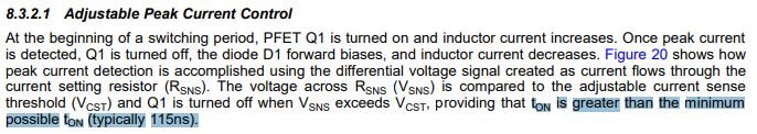

Could you tell me about ton min spec?
There is a problem that pulse skip occurs in the customer board when the temperature is low.
The root cause is the Vsns noise when turning on.
However, it was found that the Ton min spec is also related to the pulse skip phenomenon.

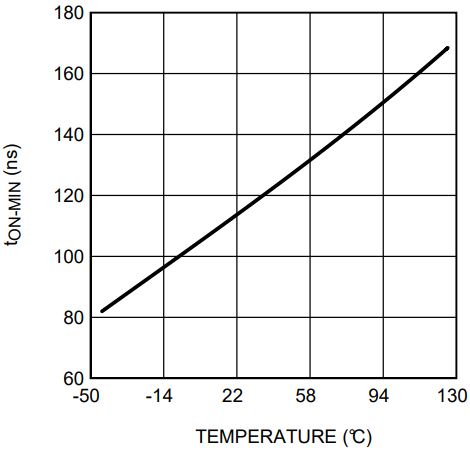

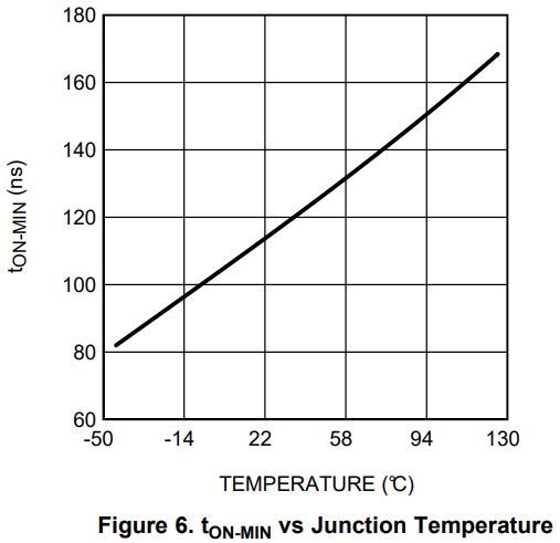

The following graph information is included in the data sheet.
In connection with this graph, the customer wants statistical dispersion information for "Ton min" specs.
Could you give me the Ton min's Min specs or individual dispersion information about the electrical characteristics below in the datasheet?

    The LM3409 does not pulse skip.  This is the leading edge blanking.  It gets shorter  as the device operates at colder temperatures.  If the current during the switch turning on goes to or above the peak current trip threshold after the leading edge blanking expires the LM3409 will turn off the MOSFET.  Current during MOSFET turn-on can be monitored on the  current sense resistor to see if it is an issue.

    However, there is a phenomenon that the pulse width becomes smaller when the IC cools and Ton min becomes smaller.
    Therefore, I would like to investigate the relationship between the problem and Ton min.

    When the LM3409 is cooled with a point cooler, the changing specification is Ton min.
    I would like some advice on this matter.
    Yusuke
  • Hello Yusuke,
    Yes, at cold temperatures the Ton-min is lower (this is also leading edge blanking time).  Their waveform is the issue, the diode recovery overshoot would be okay if there was no ringing even though it is rather large as well.  There is inductance in the switch loop or the component(s) used need to change.
