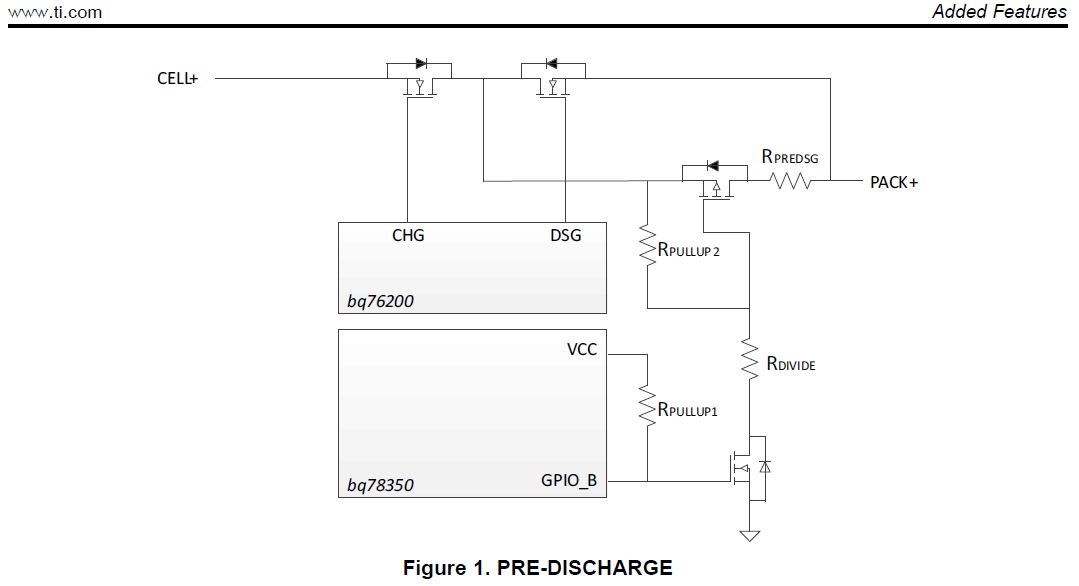

We also added a pre-discharge circuit, as the one of the BQ78350-r2 Addendum (SLUUBM6).
The power supply of the BQ78350 (VCC) is the RegOut voltage, from the BQ76930.

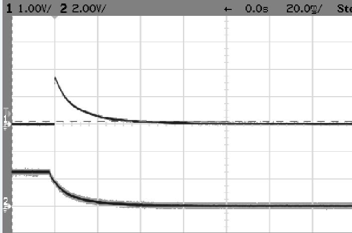

We are facing the following issue: when the BQ78350 goes to shutdown, the pre-discharge mosfet is activated for 10-20 ms.
At shutdown, the RegOut switches off and, on the falling edge, the BQ78350 resets and leave free the GPIO_B output. On the GPIO_B there is Rpullup1 resistor (470K) that activate the mosfet.
Probe 1: GPIO_B;      Probe 2: RegOut
Due to power on the Pack+ for 10-20 ms, a pulse on the TS1 boots on the BQ76930 again. So, the battery never shutdown.

  • Hi Devis,
    A supervisory function would avoid the issue you describe.  That may be a lot of circuitry.
    The BQ78350-R1 data sheet does not caution against a capacitor directly on the GPIO pin, it should work.  You may want some resistance between the pin and capacitor.
    The only BQ78350-R2 adjustment which seems related would be the polarity, selecting active low when PDSG is on.  The switch circuit would then need to detect a difference between VCC and the GPIO rather than a simple voltage on the pin.

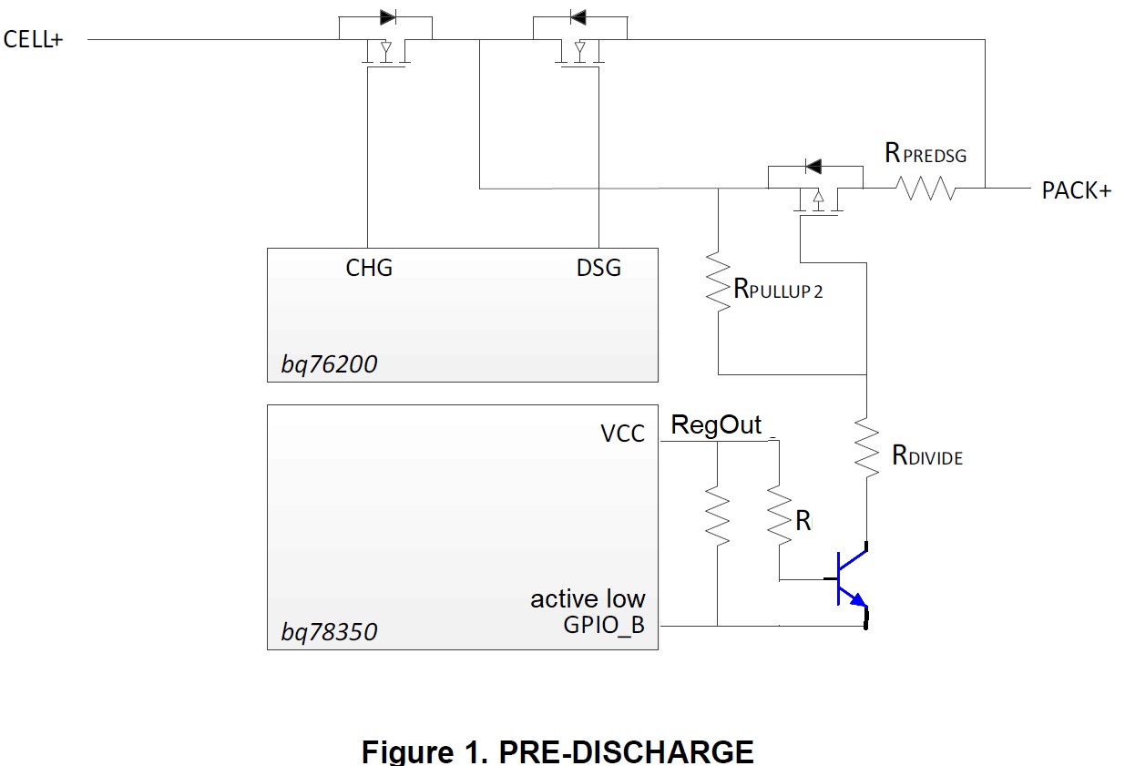

    Instead to use a capacitor, probably it is better set GPIO_B active low and add a transistor as on the following image.
    What do you think?
    Thanks a lot for any your advice.
    Regards.
    Devis
  • Hi Devis,
    Yes, I think the proposal would solve the issue.  Things to check would be the current required through RPULLUP2 and transient coupling through the transistor to the GPIO.
