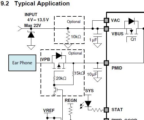

1. What purpose of PMID optional MOS circuit?

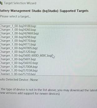

2. bq25619 cannot found in Battery Management Studio v1.3.86.6, how can I have it?

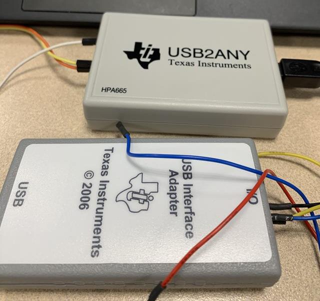

3. Can I use USB1Any connect EVM? or need EV2400?

    1. The purpose of optional PFET is to have reverse blocking and short circuit protection. When the charger is in idle mode, PFET turns off so PMID voltage will not appear on VPB. When VPB has short, PMID voltage is pulled low that triggers PMID_GOOD to turn off PFET.
    2. Could you send an email to h-mao@ti.com?
    3. Need EV2400 to connect EVM to PC
