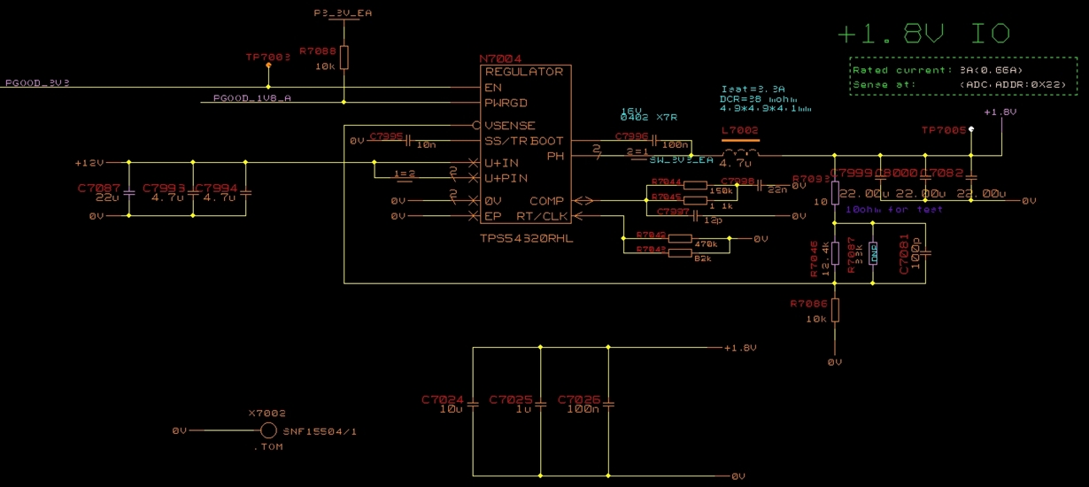

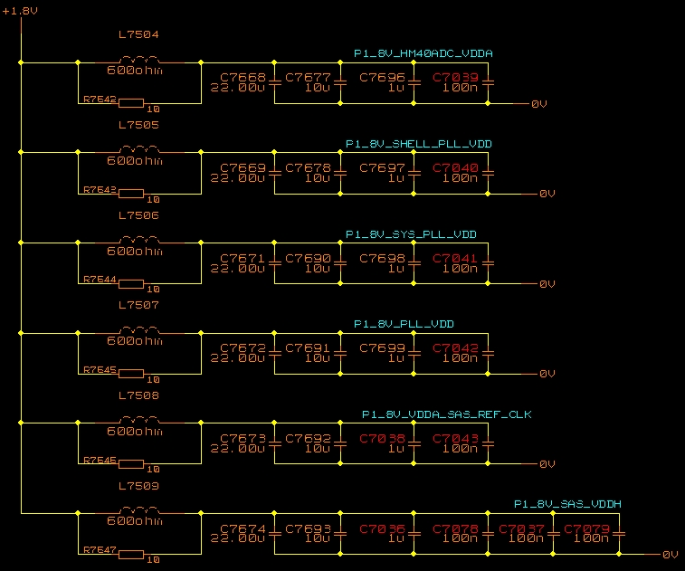

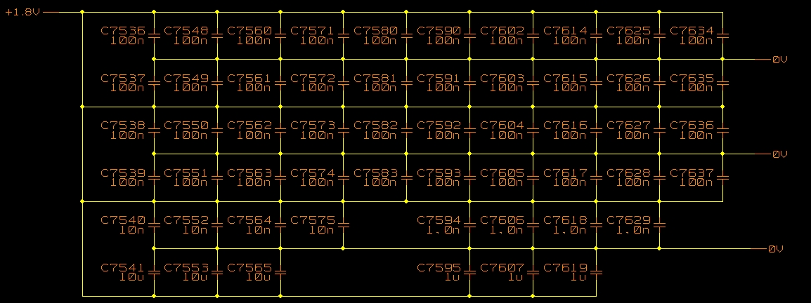

We are using TPS54320 to step down a 12V input to 1.8V with a 1A nominal load.
Both TI WEBENCH® Designer and our loop test result show we have enough Phase and Gain margin.
While the 1.8V will randomly power off, it seems to be very sensitive, could you help check our design to see what could be the root-cause?
Here is the schematic and power loop test result.

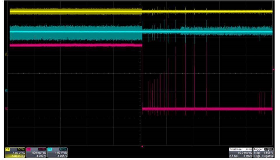

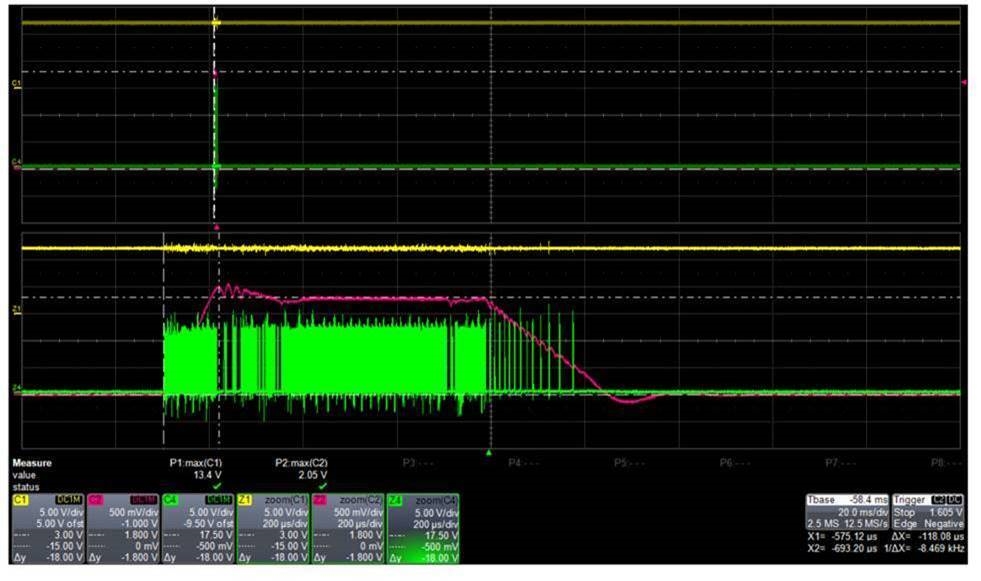

Here is the waveform when unexpected power off happen, channel 1(yellow) is 12V input, channel 2(purple) is 1.8V output, channel 3(blue) is Enable control, channel 4(green) is SW waveform.
When power down happen, we didn't any overvoltage or undervoltage in the output.
After power off, TPS54320 try to power up for several times, but still failed with following waveform.
