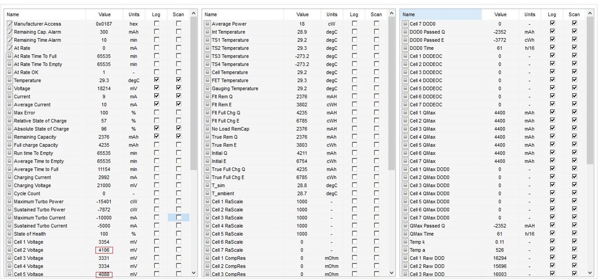

  • So, it seems that charge cycle finally completed normally.
    Two things surprize me:
    1. Initial On/Off oscillations at the beginning of charge.
    Maybe some protections activating?
    2. Anomaly rapid voltage increas near the end of charge.
    I suppose it is because 2 cells (2 and 5) are weak.
    Am I right?
  • Hello Vladimir,
    Did you change your other values to support 5 cells instead of 6? During the oscillation periods, do you see any of the COV or CUV bits set?
    Are these issues seen with other battery packs? I find it odd that the voltages in two of your cells are so widely different from the rest.
    I still see that your discharge rate is too high, your discharge rate should be between C/5 and C/10.
    Luis Hernandez Salomon
