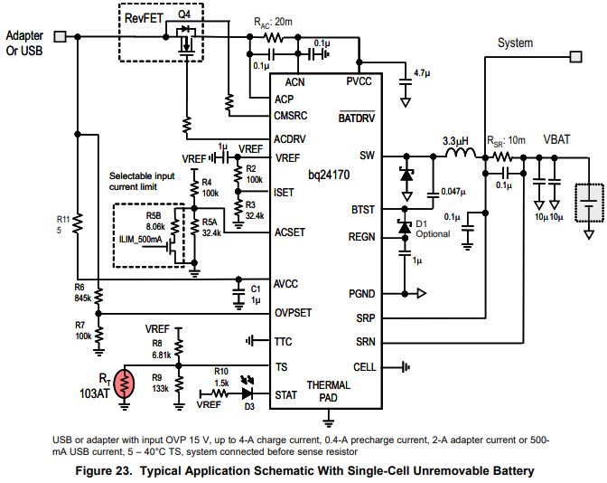

  • Hello Jeff,
    Thank you for your kind response.
    Based on your advice, Selected bq24170 and bq24616.
    However, when operating on 1cell Li-ion battery only(3~4.2V), the device is expected to be in the OFF state.
    Is my understanding correct?
    Is there anything I should be careful about when discharging 10A?

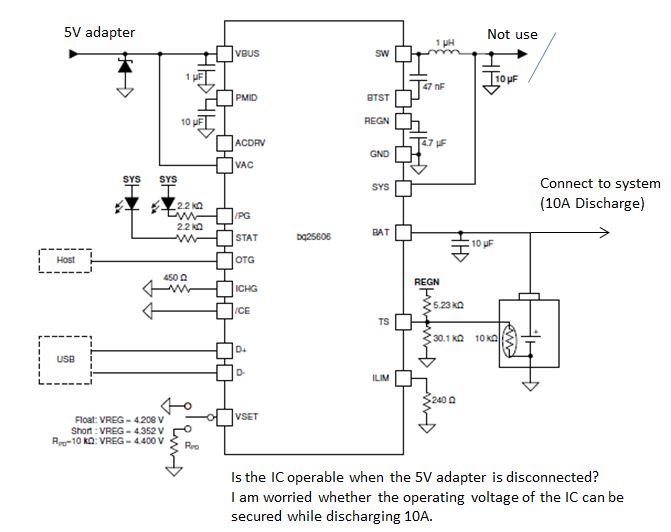

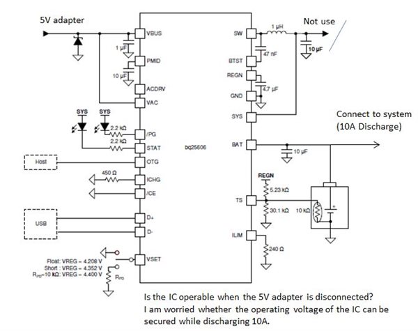

    I am considering the following circuit.
    It is the understanding that when 10A is discharged, the charging current and the battery discharge are summed and output.
    Could you give us your advice on the expected behavior at this time?
    Yusuke
  • Hi Yusuke,
    The BQ25606 internal BATFET is only capable of supplying 6A continuous discharge current.  The buck converter is only capable of supplying 3A maximum output current total = charge + system current, assuming the input power is high enough to allow this.  In the early post, you mentioned that the input adapter would be removed when 10A discharge occurs.  So, I suggest that you add an external FET between SYS and BAT to provide the majority of the 10A discharge current and turn it on at the same time that you turn off the input supply.  That FET needs to have RDSon lower than the internal BATFET's RDSon.
