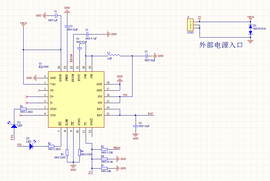

BQ25606: bq25606 could not charge fast
Part Number: BQ25606
Dear team,
Customer now use 5V/3A adapter to charge battery through bq25606, full capacity voltage should be 4.2V. But customer measured when Vbat is 3.8V the current will decrease from 1.8A directly, it will need at least 7 hours to charge battery full.
Here is the schematic, I have suggested customer not float OTG, change TS resistor to 10K pullup and 10k to GND. And customer measured the VIN, it will not exceed the maximum power.
Please kindly give some suggestion, thanks.
