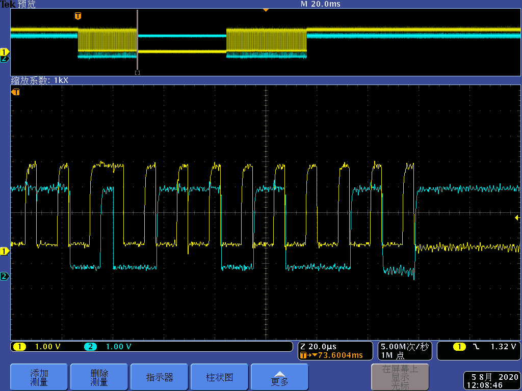

Hi Ti Team:
UCD90160ARGCR is used. The I2C bus operated under the current SDK cannot detect chip address 0x34, but each register of 0x34 can be accessed normally. No error is detected in reading and writing, and the read information is consistent with the off-line burning configuration.
UCD90160ARGCR USES PMBUS protocol address and may not be compatible with I2C detect support. Is there any special instruction format (refer to slvu352g_UCD90xxx Sequencer and System Health Controller)?

    How do you detect the address 0x34? UCD90160A does not support quick command format which is to send address without any data or command followed.
    The way to detect is to read 0xFD command from the target address.
    Yihe

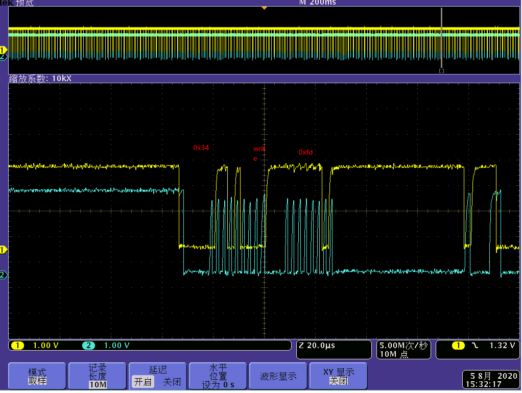

    -->The following is our detect  waveform,ask you said, direct reading is not supported.
    -->We measured the UCD90160A waveform scanned by "USB Interface Adapter ", could see that the GUI software wrote 0xFD to 0x34.
    and how does 0xFD operation under the I2C command?

  • Hello
    0xFD is a block read only command, please refer section 5.5.7 of http://smbus.org/specs/smbus20.pdf to understand the protocol of block read.
    Yihe
