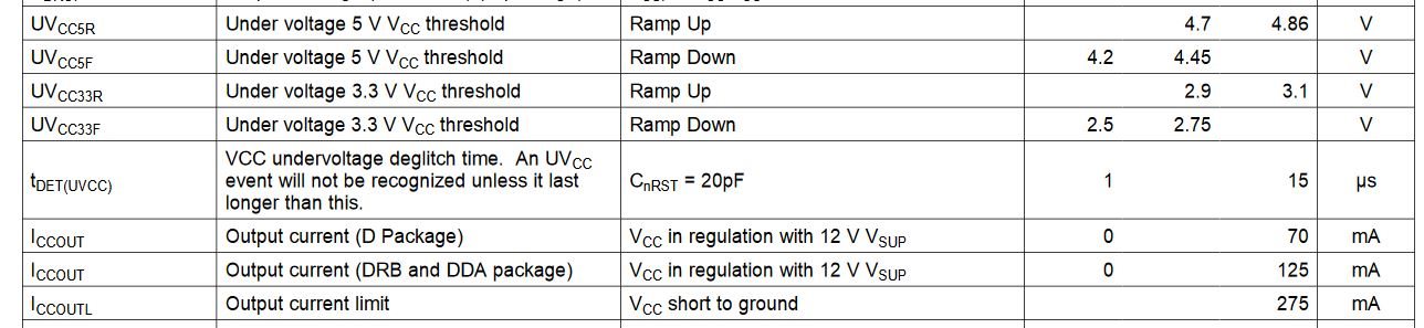

    It's all about whether the TLIN1028 can pull up or pull down the EN pin to meet the TPS7B84 datasheet requirements while not exceeding the abs max conditions.
    According to the TPS7B84 datasheet, the abs max voltage on the EN pin is 42V, so that's not an issue, and it cannot be toggled on / off for greater than 5 kHz (which also should not be a problem).
    The TPS7B84 datasheet lists the following voltage thresholds and current requirements for the EN pin.
    As expected the TLIN1028 is more than capable of driving this EN pin current.  By this analysis, you can connect the two directly together if you wish.
