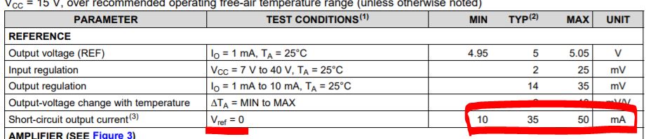

    Could you give me advice about Vref voltage?
    My customer measured Vref voltage that was 5.6V.
    The current is flowing over 1mA.
    What kind of anomalies are possible?
    Sincerely.
    Kengo.
    Based on datasheet, Vref should be in 4.95V to 5.05V on VCC = 15V when Vref pin Io = 1mA. If your test shows Vref not within the datasheet on the same operation condition, it is likely the IC on your circuit is somehow damaged or with some defects from possible damages. You can replace with a new unit to retry.
    If IC not within specs, then you may contact your local TI sales, and ask to start failure analysis to see what possible damages or defects to be and help you to eliminate possible causes in your circuit.

    Do you have a graph of changes in VREF voltage when it is 1mA or more?
    And,is there the MIN/MAX on-time or off-time regulation for output?
    Sincerely.
    Kengo.
  • Io from 1mA to 10mA Vref regulation is within 35mV so very small compared to 5V. If Io > 10mA, Vref is shutdown to zero. These are all in the datasheet. The Vref is in analog and no min/max on or off time. If you see on and off, it is likely you triggered short circuit, and you need limit your current in between 1mA and 10mA.

    When Vref=0V, is Io 10mA~50mA ?
    I'm sorry that my explanation is bad.
    I will ask you another word of the same question.
    is there the MIN/MAX on-time or off-time regulation for C1pin(8pin)or C2pin(11pin)?
    Sincerely.
    Kengo.
  • When Vref = 0, its output current can be between 10mA and 50mA.
