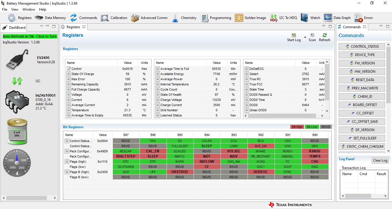

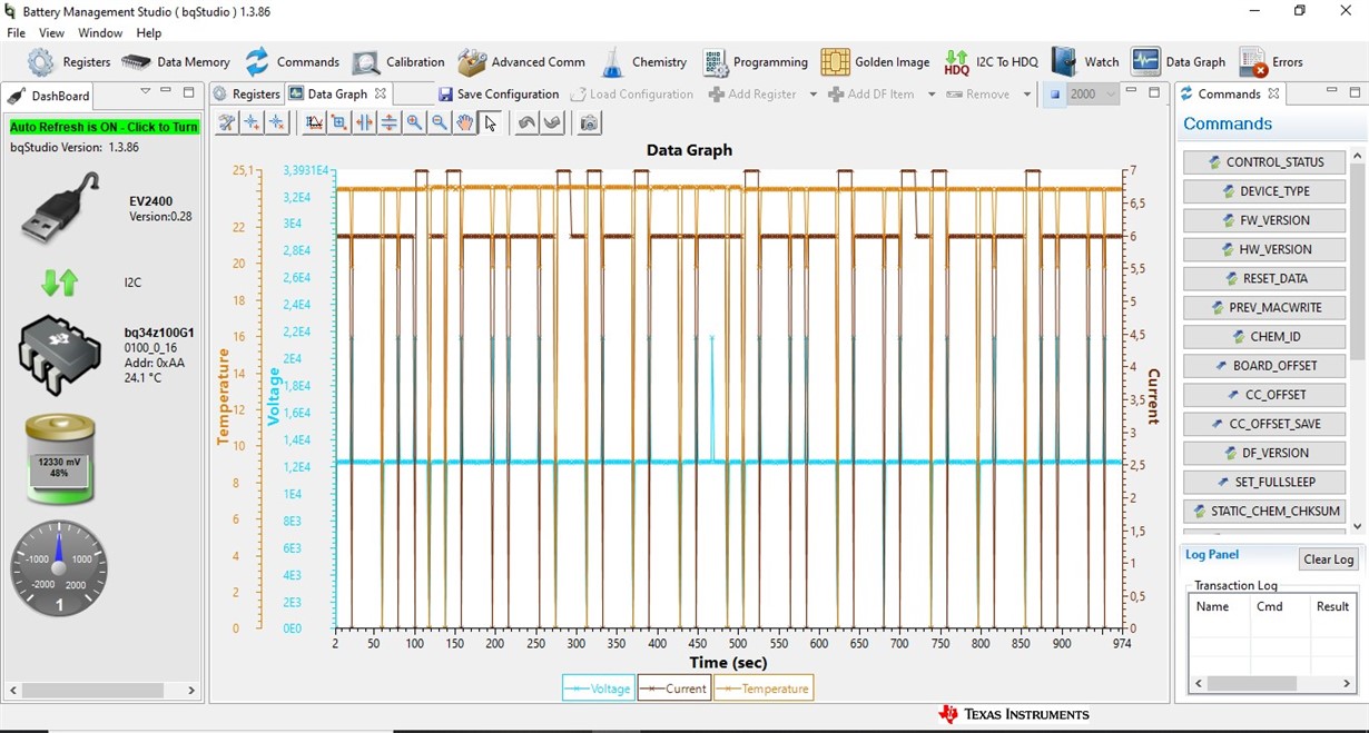

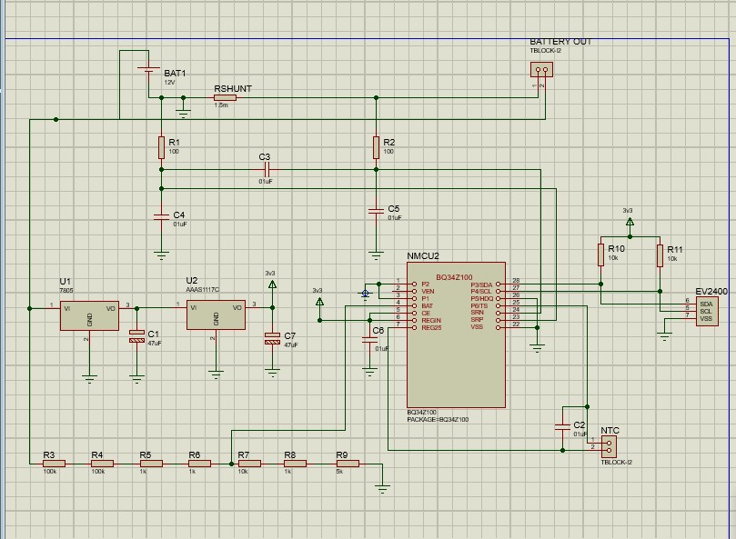

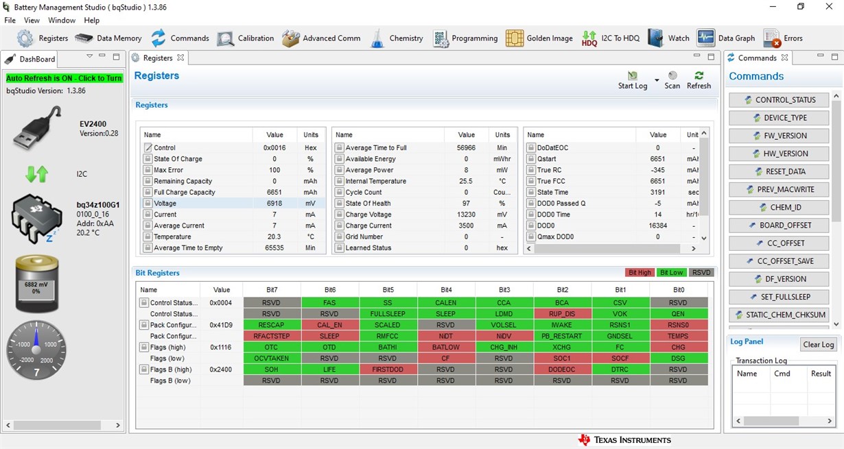

hello when setting the volsel parameter to 0 the indicator voltage is 6870 volts when I make the change to volsel at 1 the indicator voltage is 0 I use a sterile voltage divider for 12 volt lead battery
Thank you for your attentionarchivo12vpba7a.gg.csv
